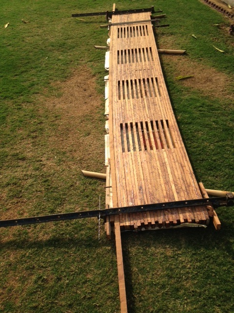

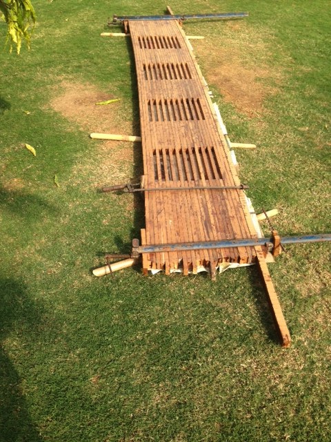

Pics of diving platform.. Final finish after sanding and at least 10 coats of Varnish at 24 hours interval will be 12' x 22''x 1 1/2''.. I have screwed the platform with six stainless steel 316 bolts. Will post some more pics later.
Image 1.jpg (157.43 KiB) Viewed 2447 times
Image 2.jpg (119.95 KiB) Viewed 2447 times
Shams
