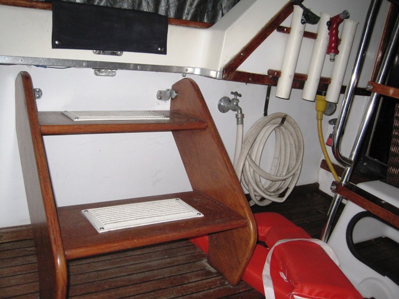

We have a 30A shore power connection on each side of the cockpit in identical locations. Since we bring both power cords in on the starboard side at our slip, we end up with one of the cords running along the cockpit floor under the sliding door. That will be addressed along with a galvanic isolator or isolation transformer fairly soon, as I have a dock neighbor who seemed to be leaking over an amp AC when I went down the dock with a clamp ammeter. I just got a Fluke 87-V meter, partially because I want to look into corrosion protection on our boat.
I am not sure if one of the panels was originally on the port side, but will inspect the next time I get out to the boat. The dock water inlet and pressure regulator are now where the panel would have been.
We do have a crossover that is implemented by a breaker on the left side panel connecting to the power in on the right side panel. There are no lockouts, so you have to be careful switching that breaker. I probably should come up with some type of cover or lockout like a transfer switch would have.
The crossover breaker is the only one in the left side panel that has a stranded wire connected to it!
