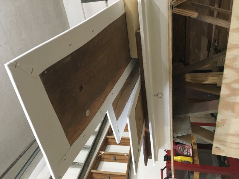

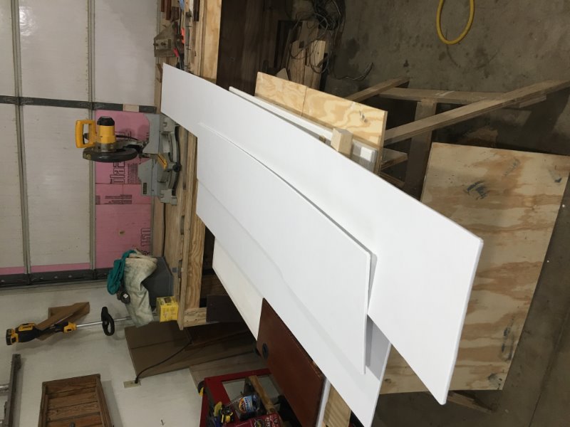

Just finished covering the cockpit combing panels. At least I think that's what they are called. Also I have the new sliding doors for the galley and head ready to install into the new tracks I put in last weekend. This week is bottom paint and gel coating the cockpit deck if the weather holds that is.

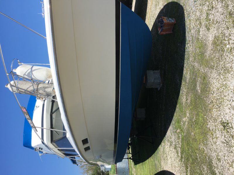

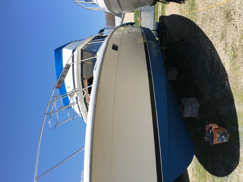

OK I had a good window of weather finally so I got the first coat of gelcoat down on the cockpit deck and cleaned up the bottom and gave her another fresh coat. I think a soda blasting is in her future though. I'm hoping to get the nonskid down next weekend and reinstall the bridge ladder so I can drop her in the water on Monday next week.

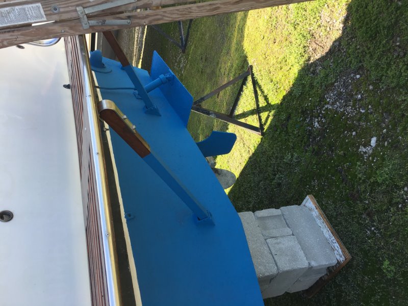

It looks like your boat is supported by hollow core cinder blocks. I have heard of them crumbling and would not use them myself. Wood blocks are much safer.
