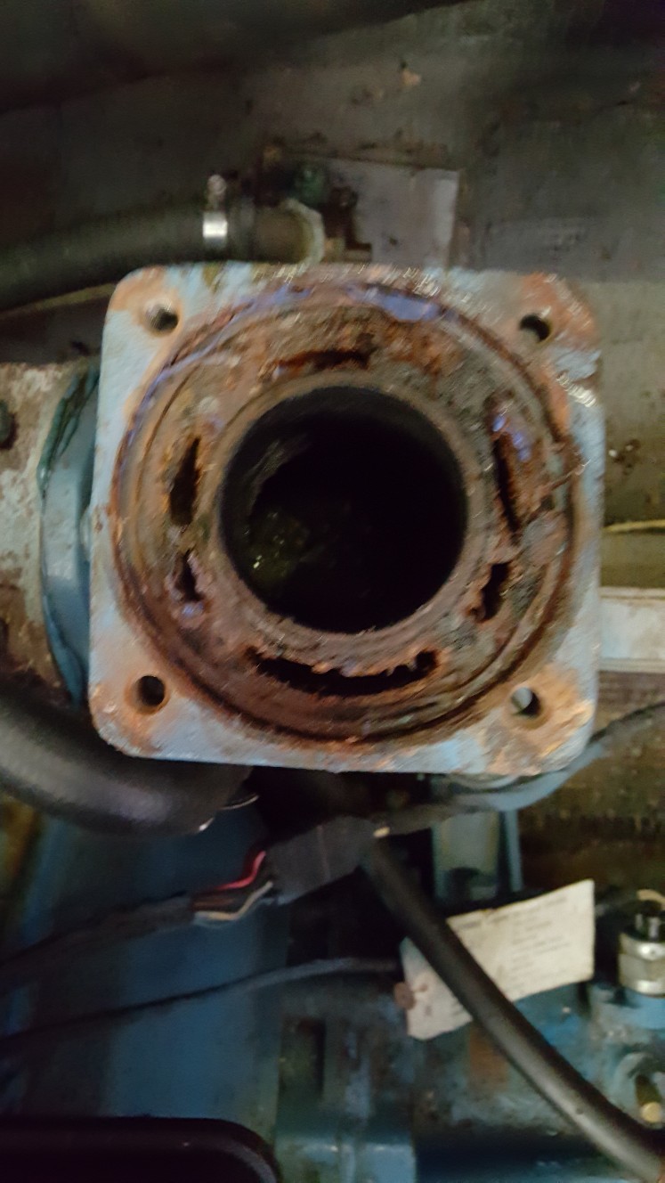

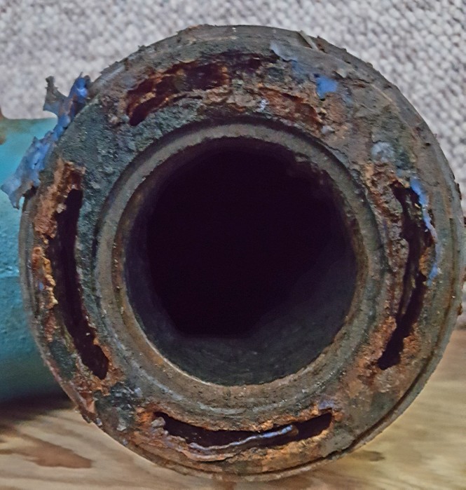

Re: List of questions on new (for me) F36 1976 on first weekend out
Holly crap....,
Well that's a winter project.....
So I removed the offending riser..... The corrosion is quick extensive. My plumbing cam just broke so not able to see if there was any perforation through the exhaust wall.
Sorry for the crappy pics.
