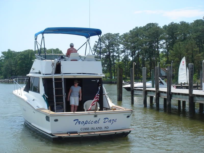

Tad, I looked into this. All the ones I have seen have the top of the platform even with the top boot stripe. That's well above the exhaust.

Here's my friend's F36 with the platform. Notice the boot stripe/platform relationship.
