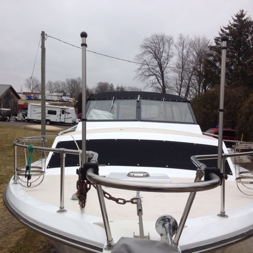

Then after the new glass install, have one of these made and never replace the windows again.

I got a quote for $400 to fabricate a Sunbrella window cover for my F26, so I'm going to have that done. I need to install snaps in the fiberglass. I'm going to overdrill and then fill the holes with epoxy to prevent any water intrusion. It shouldn't be too hard.
