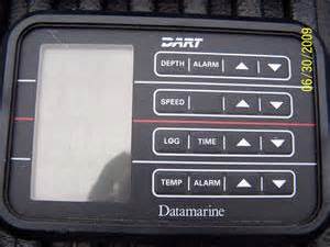

Yesterday, my depthfinder started acting up and now just shows - - - across the display. if I use the other functions like the alarm the display works fine. I took it out of the dash and all the connections were fine, no loose wires. Going to the other end I started looking for where the transducer was. I don't recall exactly where it was on the hull but it was starboard side about 24 inches out from the keel. I'm assuming that these were factory installed since I understand they didn't core the hull in the area where there would be a thru hull fitting. I opened up various hatches and looked around but I can't find it. I'm getting nervous that it might be under the holding tank. It's too cold to go swimming to get a good measurement. Anyone have any experience locating and changing out the transducer or installing a new one?

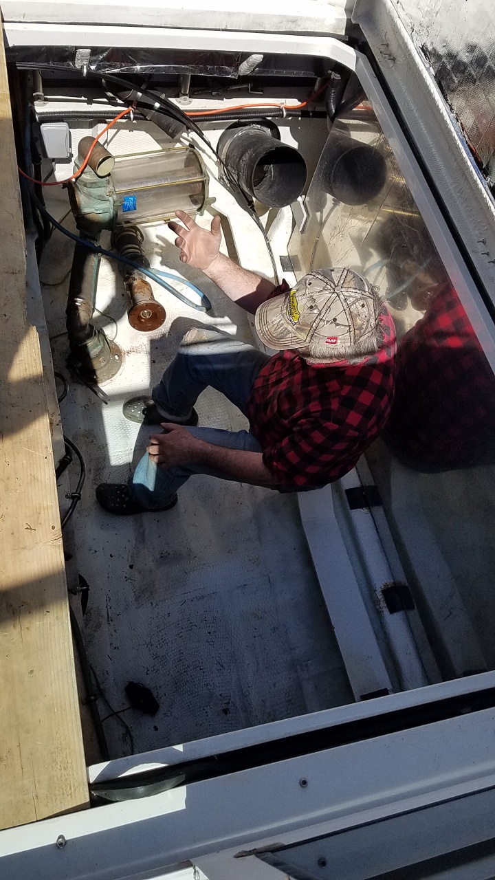

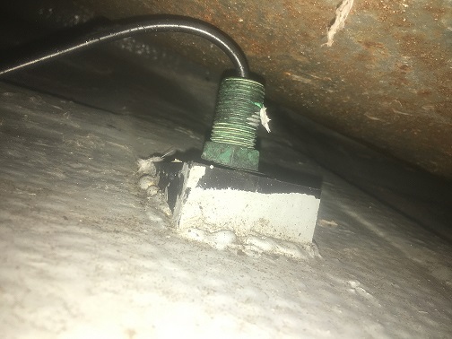

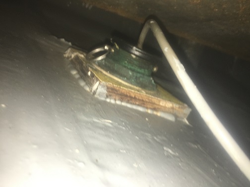

With the heat wave we had, no problem diving under the boat to find the transducer. No wonder I couldn't find it, it's under neath the starboard motor. The second transducer for speed and temperature is under the port motor. It has a pin in it and at one time I guess you can pull the unit out to service it. I have never had one of these transducers with a paddle wheel. I'm beginning to think spending anytime salvaging this system is a waste of time. The boat had gas motors in it originally, so when they switched to detroit diesels, servicing these transducers wasn't an issue. Any 12M owners have a good location for a new transducer?

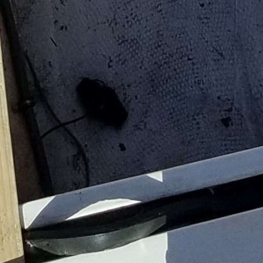

Ours sit in the center bilge near the A/C and generator thru hulls. On the 1988 12m Sedan, that section of hull is solid glass.

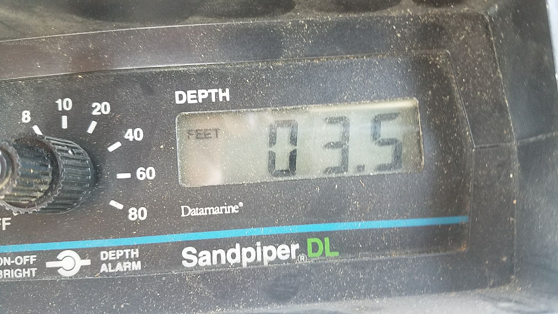

My Datamarine unit was showing its age and I could barely make out the numbers. Didn't need the speed log input so I replaced it with a Sandpiper model that just shows depth. One thing I noticed was that the RCA type jack that plugs into the unit has to be tight. Otherwise it displays " ------ "

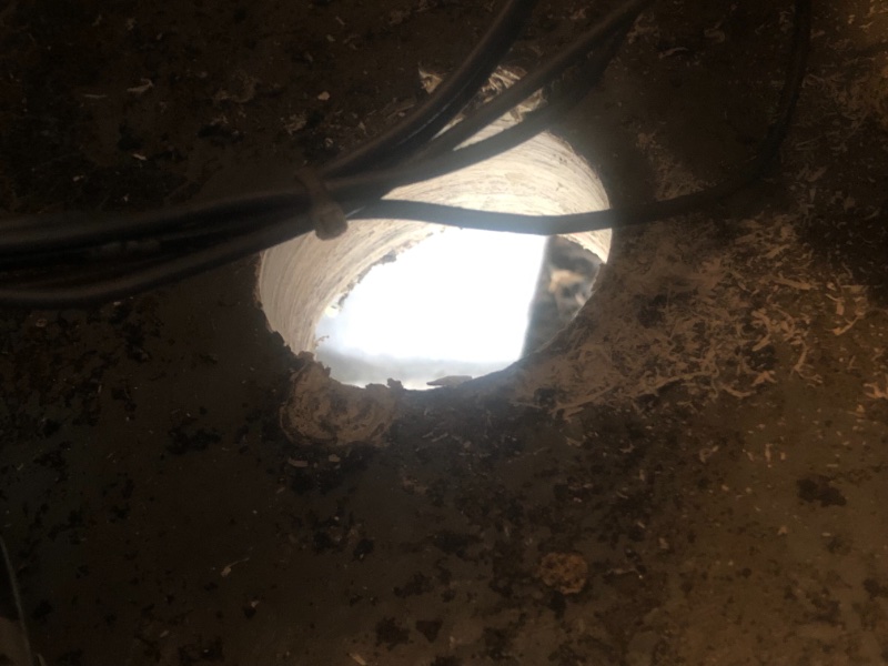

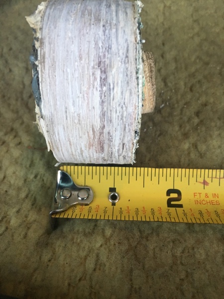

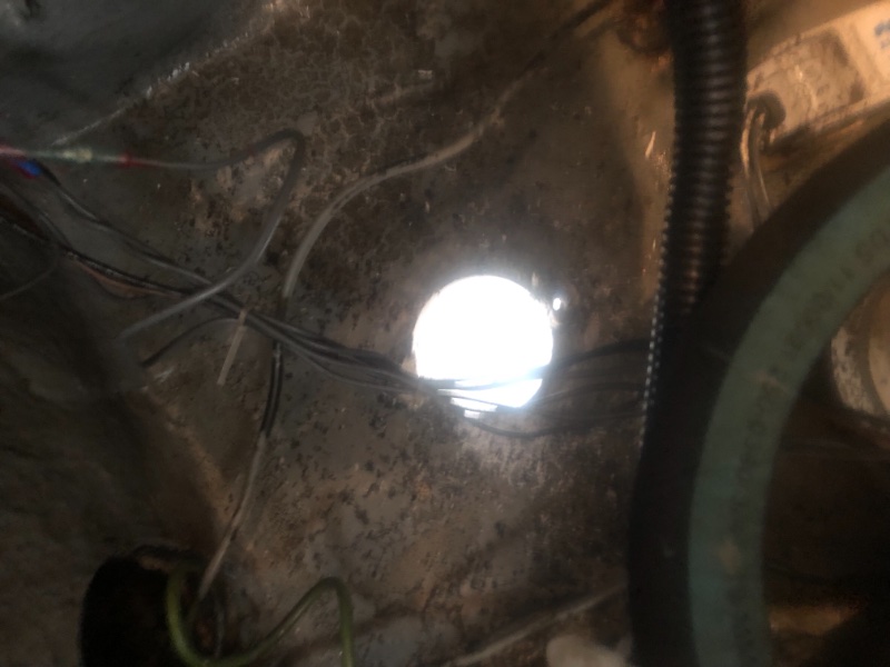

Confirmed 100% fiberglass in that location. Phew.
Re: 12 Meter Express -Dart datamarine depth finder
It must be the photo but that looks like a cored section . With the reflection its hard to tell
tcollins2
Posts: 172
Location: Huntington, NY
Post by tcollins2 »
Nope, 100% fiberglass. Here’s a close up of the cut, about 1-3/8 thick.
Much better , looks good
