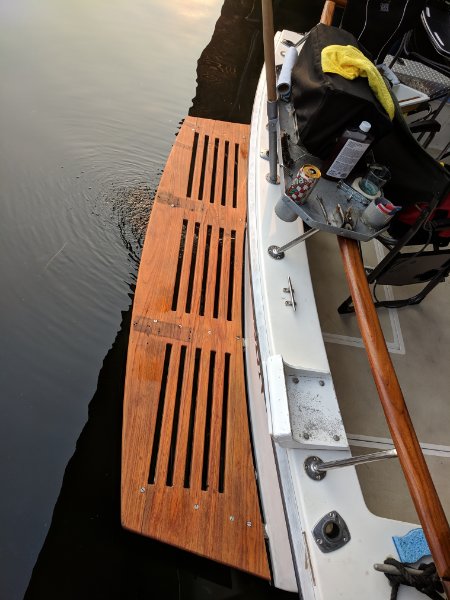

I love doing projects. The key to boat projects is one at a time and try not to let them spool in to larger projects. Like when I did the bright work I realised all the stantions need to be rebed in sealent and the fasting hardware needs replaced and backing plates should be added. I was half way there having all the rails off and choose not to do that. That is it's own project and one I'll tackle over the winter.
Re: New F32 owner
Some bright work photos..
- IMG_20180822_180647.jpg (56.03 KiB) Viewed 9628 times
