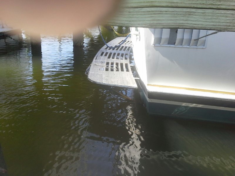

The F36 next to mine has one , if I can remember I will take a photo and mess distance off the water . Painted Water lines vary boat to boat . Mines the same year and there is a big diff .
Posts: 12723
Re: F36 swim platform
Its just slightly lower then the spray rails on the side ,maybe 3/4" . Sorry about my thumb . A F32 looked about the same place (no spray rails )
F36 Platform.jpeg (79.54 KiB) Viewed 8728 times
The photo Paul posted looks about the same as ours. Just guessing, the platform is about 8-10 inches above the waterline.

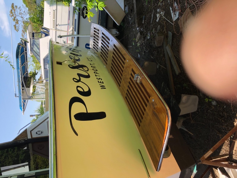

Here’s the finished product!
Posts: 12723
Looks good
Very nice!

Another shot...
