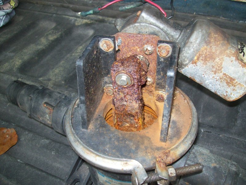

Did they sell this boat with a standard marine flush type toilet and made the vacu-flush an upgrade, as done on some other boats???. I note there is caulking around the toilet rim just below the area of the seat. Can you lift out the toilet? Is that how you rebuild the seals there?
Got the vacu-flush pump out today. Picture attached. Looks pretty rough to consider rebuild. Don't know about Vacu tank.
Toilet does not seal and hold water.
Thanks for the toilet reference. Will look into it.
Re: Changing toilet system from vaccuflush???
I believe it came std with Vacuflush bit not sure . Not sure about the head it self on rebuilding bit the rest is junk and needs replacement

That toilet was standard for that boat and year, so there probably isn't any other marine toilet that would drop in, so will replace it, but not with vacu-flush. Will remove caulking around seat area and see if I can lift it out to see hook ups for water etc. Than the decision to be made is to cut it out or install another system over the shower drain area.
Not going to worry about resale value. Have 3 grandsons with families, son-in-law, daughter, and my wife all like to fish. Snapper fishing, etc, watch the Blues at their home time shows, and watch the Bands on the blackwater up the river on a Fri. night. And of course 4th of July celebration observation from the boat. Not going to live aboard nor travel distances, probably never use the shower. This is the 5th different style boat for us and since I am 85 years old it is my last last one.
Will retain the macerator pump out system and the dock side pump out system from the existing holding tank. Just got to choose a more conventional marine toilet that I can use with the existing arrangements either by cutting the existing one our or just moving over a bit and putting on the shower grate. Don't mind using fresh water for flush. Not sure about electric toilet. Figuring a "pumping" type toilet now. Any suggestions for best ones under $500.00 would be appreciated. In the mean time I have a big porta potty in there. Thanks for your help.
