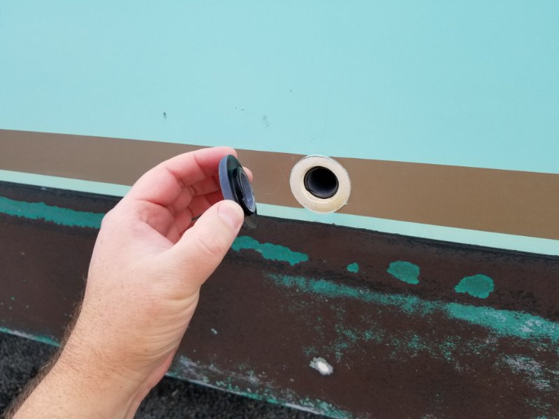

Re: Best way to find a leak??
Bronze below the waterline, stainless above.
Plastic sucks.
Don't be the guy in the picture. (just happened to touch it after we hauled out and it came off in my hand)
Plastic sucks.
