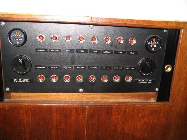

I can't figure out how to pull fuses to check them. All I see is the red head of a fuse cover recessed into the panel. Tried pushing for release and turning with my fingertip? Any help??

Sounds like circuit breakers not fuses . photo ?
Re: 1979 F-40 Fuse Panel
If it looks like this, you have circuit breakers. Push them in to reset.

The red indicator will have popped out if the breaker has tripped.
