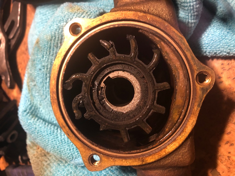

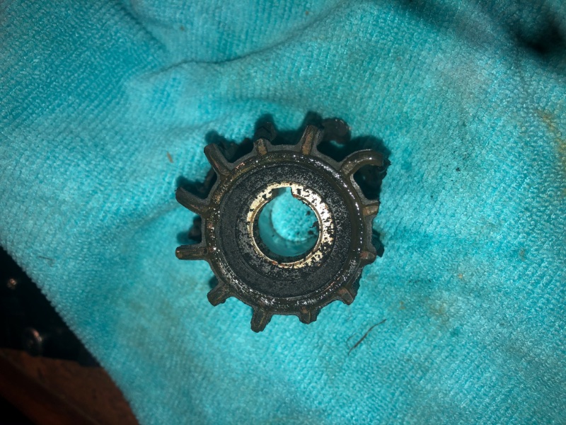

Raw water pump impeller was in very bad shape new impeller and all is well.
Posts: 12723
Re: Overheating Chrysler 360
Glad its ok . Did you fid out why the impeller burned up ? I assume it was new as the pump was rebuilt .
mrjake56
Posts: 21
Joined: Sat Sep 23, 2017 4:32 am
Location: Clinton Township, MI
Post by mrjake56 »
The impellers were the first thing I replaced two years ago when I bought the boat. After working on it all this time running to check whether the latest repair solved the problem, and to maneuver in the marina at launch and haul-out with plugged exhaust elbows it burned up. I always shut it down when the temp exceeded 180.
I never went back to the pump because I already rebuilt it. I guess the moral is, if your overheating problem requires lots of repairs and leads to a complete blockage and no flow out the exhaust, recheck the impeller. I luckily found a used one left by PO that was still useable so I could finish winterizing
Makes you wonder how the marina that charged me $750 with no oil change (they wanted another $450 for that) last year did the winterization ...
