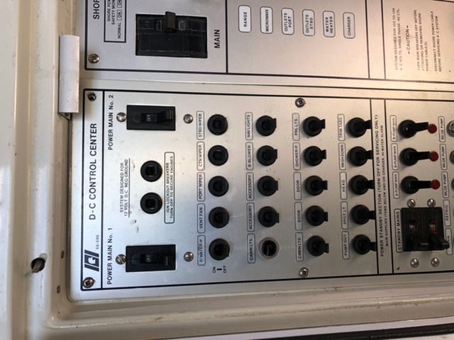

When I fully connect the starboard engine battery, turn on the power main, and have the ignition Colour off, I get no alarm. With the starboard power main on and the ignition lockout on the oil pressure alarm sounds. The oil pressure alarm turns off when I turn the ignition lockout off. I believe this is correct. I’ve read that the oil pressure alarm will sound when the ignition has power and there is no oil pressure. once running and oil pressure rises to a good level the alarm will turn off. So for both engines when the power main switch is on and the ignition lockout is off it should not sound.
Here’s the problem.... when the port battery is fully connected and the power main switch is on, the oil pressure alarm sounds whether the ignition lockout is on or off. I believe this not correct. I should be able to have the batteries on for cabin and accessory use without having to listen to the alarm if my ignition is off. I believe there is some kind of wiring issue somewhere that is connecting constant power to where I should have switched power for the ignition lockout.

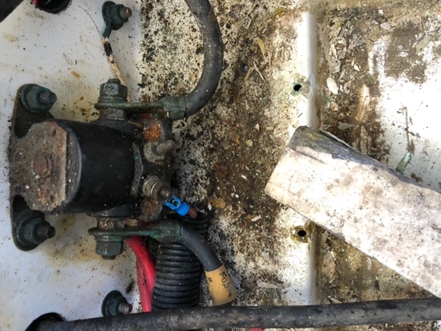

Some photos
- Paralleling solenoid
- 6147D690-3C54-4187-90FE-9F239BBFA633.jpeg (146.21 KiB) Viewed 2843 times
- Switch board
- 57F5C915-04BF-48D8-98D9-3E6CEF5E32DE.jpeg (102.25 KiB) Viewed 2843 times
