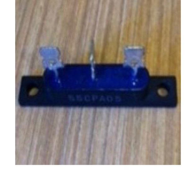

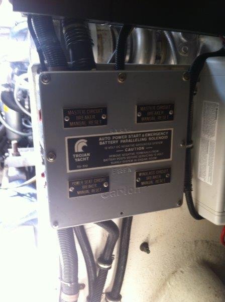

I will try again . Its a really simple system . The diode is used so it works off both sides . And the 2 way switch is used so it can use either battery to activate the system in case one battery is too low . I will draw up a generic diagram later ( one should be in your owners manual )
The diode should be near your start switches . here are photos of the diode and a 12 meter (diesel) box breakers and relays will vary on the boat . box may be black and or smaller . Please see your manual .
trojan box inside small.jpg (57.62 KiB) Viewed 6337 times
trojan box 4.jpg (38.71 KiB) Viewed 6337 times
trojan diode.jpg (31.96 KiB) Viewed 6337 times

What is the DIODE that Robert Cushman has discussed - I have yet to find one on my vessel
Without these TWO diodes, either ignition switch would start both engines at once. My electrical schematic says that they are located in the instrument panel, and one wire runs to the solenoid. They are wired as: Ignition switch>diode>wire to solenoid<diode<other ignition switch.
Think about it -- with no diodes and a wire to the coil on the solenoid from each ignition switch, the "start" signal travels from one ignition switch, down to the solenoid coil, then back up to the other "start" switch.

As far as the 3 way switch . It is a momentary switch that you need to hold . When released it off . When you push and hold it one way it activates the relay using 1 battery . When you push and hold it the other way it uses the other battery . The reason for this is if you have a low or dead battery there will not be enough power to activate the relay/solenoid so you then use the battery with good power by using the other switch position .

It should be noted that the diode is really 2 diodes in 1 .
