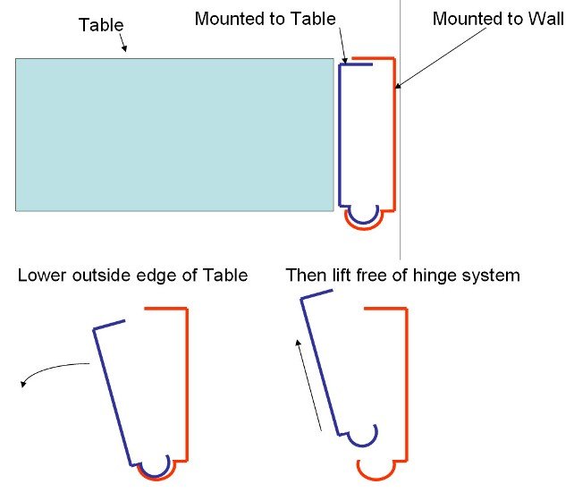

Help!! We have a new to us 1985 11 Meter dinette. I think we have the original table but we can’t figure out how it goes into a bed. Also should there be extra filler cushions or just the back dinette cushions? Any tips or tricks to make it more comfortable for some over night guests?

You should be ble to fold or remove the leg and lift the table off the wall mounts. It then fits between the seats, there should be a lip for it to sit on. The seat backs are the cushons.

On my 81 F-32 the dinette table had to be lowered (leg collapsed) to remove it from the bracket. Not up.

I had posted this a few years back but the picture appears to be gone from the original post... Don't know if it is the same on the Internationals, but for the F32 the 'hinge' where the table meets the wall works like this... To unfasten the table: fold the leg, lower the outside edge of the table until top of hinge / bracket clears, then lift the back edge up and out. To put it back, just reverse: with outside edge of table low, place bracket at back edge into the trough, raise outside edge of table to lock it in the bracket, then put leg back in place.
