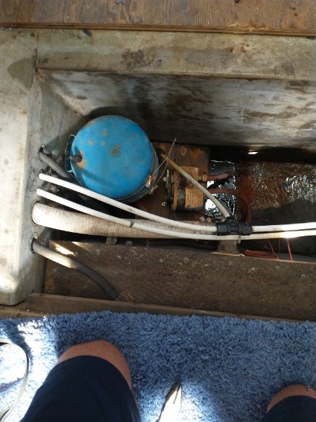

Here

The other pic is not that good

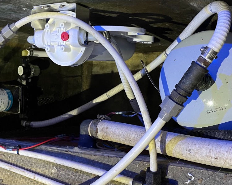

Here is a better pic for location
Make sure you add a simple water filter after the tank and BEFORE your pump, I had issues for a long time with small pebbles/calcium deposits clogging my faucets
Also my original pump was mounted very low in the bilge, after failing I moved it up about a foot, it is easier to service and will never have a chance of getting wet if you have water in the bilge

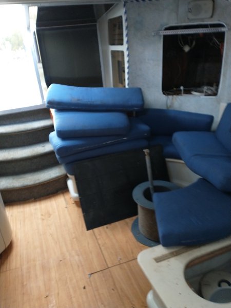

Awesome, thanks for the pics. Someone put down an engineered laminate floor and did a terrible job. That hatch is completely covered and I'll need to rip up the floor, which I planned to do anyway.

Here's the pic of the laminate floor that covers the hatch. No possible way to service anything in that hatch without ripping up the entire flooring, which I plan to do.
