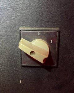

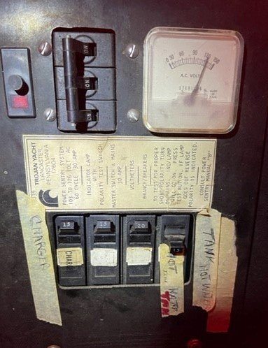

Question: Would anyone happen to know or recognize what this 3 Position Knob is for? What is it's purpose?
Position 1 = Shore Power. AC electricity is on throughout boat. Panel shows 120V
Position 0 = No Shore Power. No AC electricity.
Position 2 = No Shore Power. No AC electricity.

Probably Shore Power / AC Shut Off / Generator. My F32 is a '79 and the switch in it actually says those things, not just numbers.
Re: 1975 Trojan F30 Express - 3 Position Switch on Main Breaker Panel. What is this?
captainmaniac wrote: Mon Oct 04, 2021 5:31 pm Probably Shore Power / AC Shut Off / Generator. My F32 is a '79 and the switch in it actually says those things, not just numbers.
J agree
