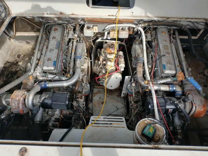

My first major step is to remove the generator. You'll notice a large hose going across the front of the starboard engine. That hose is actually the exhaust from the generator. You also notice a white smaller hose that comes out of the bilge and exit through the starboard side of the hall where the sink exits as well from the entertainment Island. The only thing I can think of that the white hose is connected to in the bilge is the bilge pump, but I haven't pulled up the floor to look under it yet. Wow, can you say Jerry rigged. I've got a good feeling I'm going to see a lot of that throughout the boat. Once I get the generator removed I'll start to tear down the engines and see what we have. I'll post pictures of my progress along the way. I've never worked on diesel engines before so I'm really looking forward to this. She has Detroit 6-71TIs with Capital gears.

Look like you will be busy for a while. Is there a water lift muffler before the gen exhaust hose goes over the starboard engine? will the Engines turn over at all?

Yes, there is a small water-filled baffle next to the generator. Engines are seized, I can't manually turn them over. I was thinking of removing the injectors to pour a penetration spray in the cylinders and let them sit a day. Either way I'm pulling the heads so it probably make more sense to just pull the head and see if I can't un-seize her. I'm going to tear down to the blocks and will most likely remove them so I can remove the crank to inspect and replace the bearing etc. The Generator is ready to pull out, don't have much information on its condition but I was told it wasn't running before she went under.

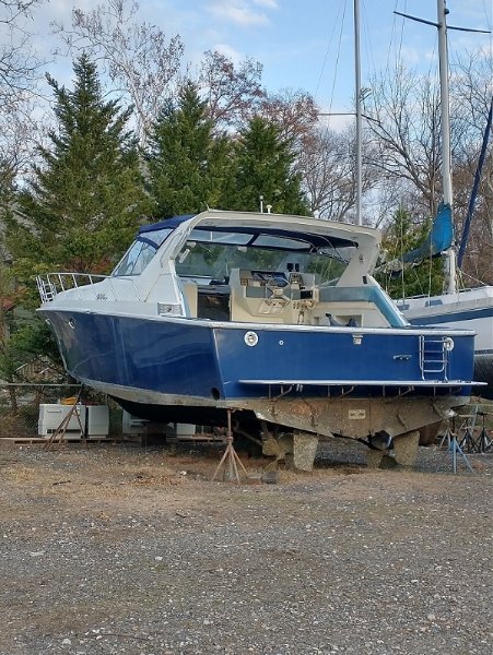

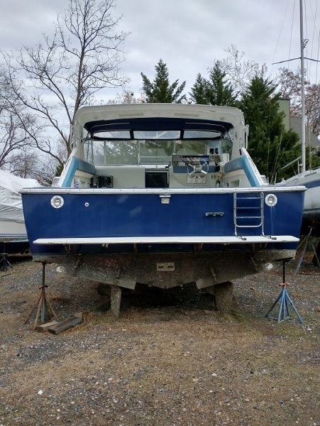

Stern Port View 12-06-21.jpg (254.36 KiB) Viewed 6818 times
