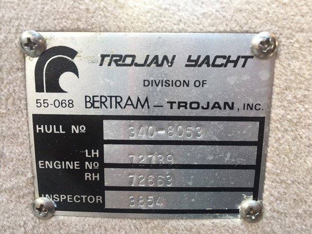

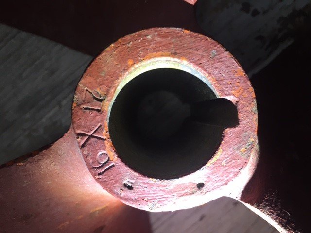

This may be a Bob question but, I'm looking for the actual factory installed propeller size for the subject vessel running 454 (350hp) engines. Not sure about the gears either, but looks like the literature supports this vessel as having 2.0:1 gears, no nameplate data on the gears located.
I've attached the size and numbers that are currently installed, they are three bladed. I have to change the propellers as galvanic corrosion has gotten the best of them. Looking for anyone with the same boat (model) that has done any changes in the size/pitch/blade count of their propeller and what your feedback is. Not looking for performance numbers, not looking to "go fast", just curious of general comments about the change and some of the reasons that led you to changing your propellers. Some folks have gone to 4 bladed, but haven't really heard why.

I have the same year mid cabin and it came with 1:52:1 VD transmissions. I have a video on YouTube when I first swapped the factory 3 blades over to 4 blades. The four blades are a little smoother AND I wanted an extra set on board so it was an easy decision.
