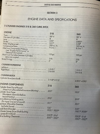

Here is what I got from the mechanical survey:
ENGINE – CHRYLSER 318 PORT STBD
ENGINE OIL LEVEL: OK OK
TRANSMISSION LUBE LEVEL OK OK
COOLANT LEVEL: OK LOW
DRIVE BELT: OK LOOSE
SEAWATER PUMP: OK SIGNS OF LEAKAGE
CIRCULATION PUMP OK OK
OIL PRESSURE(AT DOCK) NORMAL NORMAL
CHARGING (AT DOCK) NORMAL NORMAL
WATER TEMP (AT DOCK) N/A N/A
W.O.T. RPM N/A N/A
COMPRESSION (WARM ENGINE) PSI
1- 145 2- 155 1- 130 2- 145
3- 145 4- 145 3- 120 4- 130
5- 150 6- 135 5- 140 6- 130
7- 135 8- 150 7- 130 8- 130
ADDITIONAL FINDINGS
1) BOTH ENGINES HAVE OIL LEAK NEAR #7 CYLINDER HEAD BANK
RECOMMENDATIONS:
1) FILL STBD COOLANT RESERVOIR TO NORMAL LEVEL / MONITOR FOR LEVEL CHANGE
2) ADJUST STBD DRIVE BELT
3) CHECK OUT CAUSE OF LEAKAGE ON STBD SEAWATER PUMP / REPAIR AS REQUIRED
4) FIND OUT W.O.T. RPM WITH ENGINES TOGETHER AND INDEPENDENTLY
Re: Twin Chrysler 318 Engine Survey Question
I feel one engine while having high hours still may have some life left. The boat has been used and that's a good thing. Compression while a bit low on it is still in specs. I would still want to see wide-open rpm if just for a second or 2. I don't like doing one at a time. Need more info on the oil leak.
Here is the specs you can get the manual on this site ( will post the link later)
