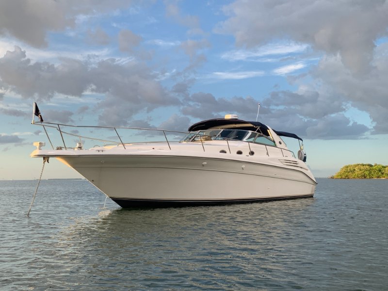

By the way, here's my new to me boat:

Harris, that new boat looks great!

rws-
awesome!
I'm jealous
what model is it?
rr
10 meter mid cabin
Re: 89 mid cabin performance
Was very difficult for me to do this, especially after sneering at this brand for years.
Boy oh boy, did I get an education on these boats
this is a 1996 450 Sundancer running CAT 3126 - 420 horse diesels
posting some info and data - whups - can't attach a pdf
KNOTS - NOT MPH - THIS IS MY ACTUAL DATA
.90 NMPG @ 23.6 kts - WOW
then throttle back to 17 kts and the NMPG goes up to 1.10 NMPG
apologies for the hijack
