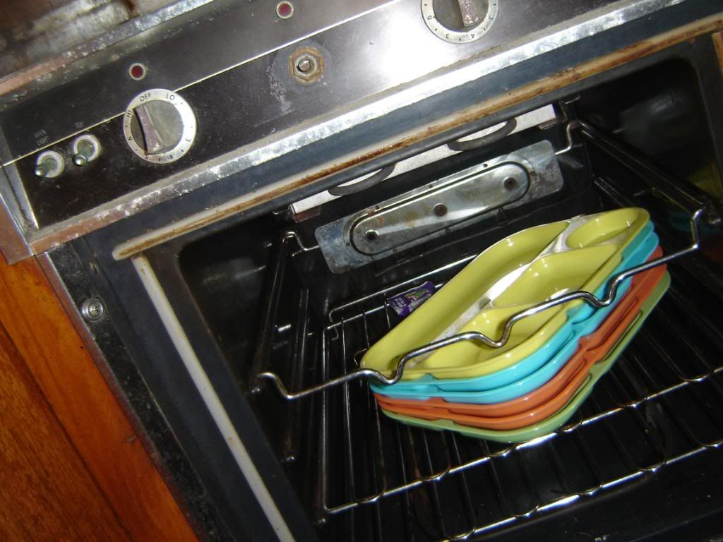

At least you got some nice china with it
Vacuum this
This will scub up clean pretty easily

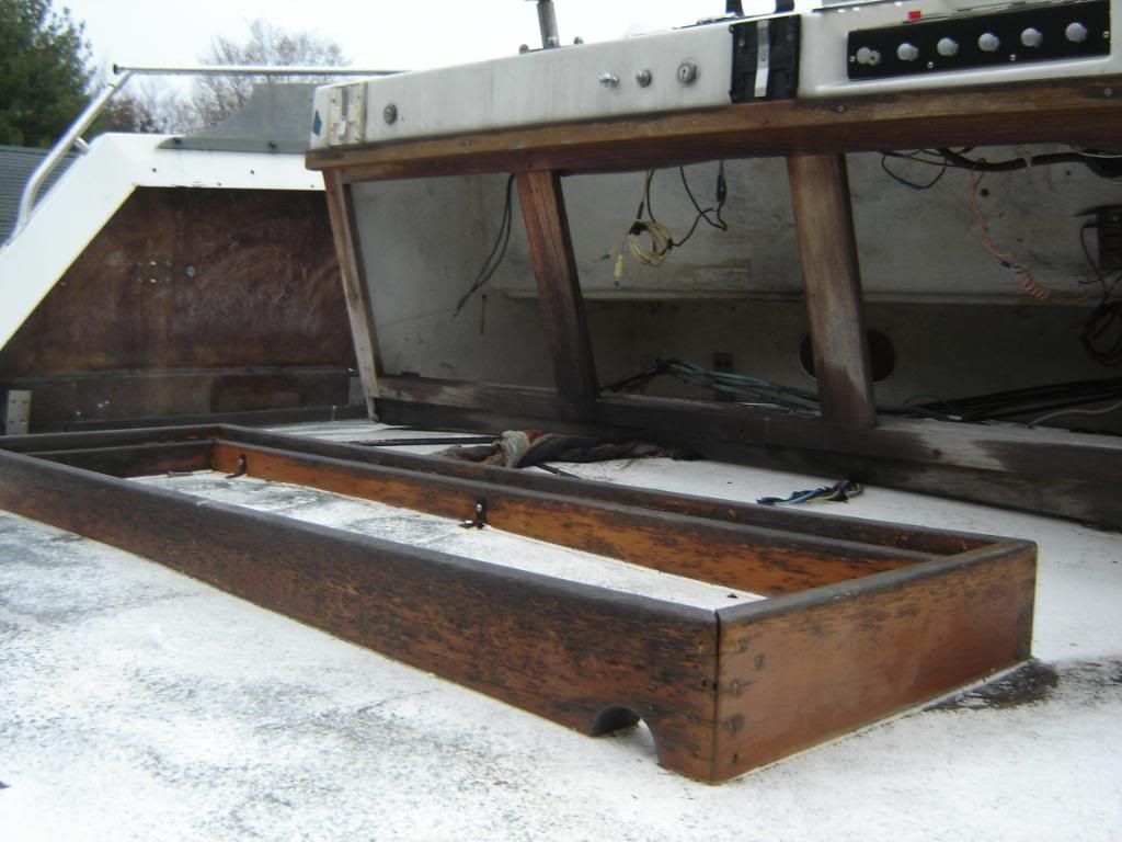

I wonder what the eye hooks are here for
Looks like the wood for the seat base is in decent restorable shape

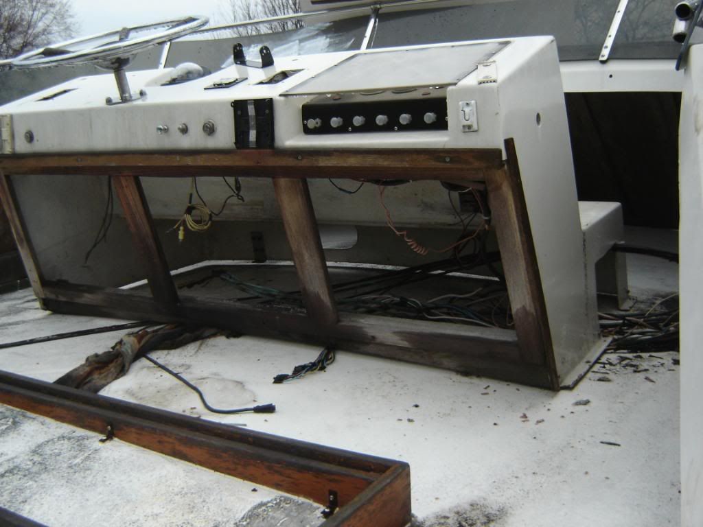

A good pressure washing and a little paint for the wood and this will prolly look new. Do the motors run? How long have they been sitting???
Everything looks intact in the engine compartments
Sanding and then Spar Varnish would make this wood look beautiful again

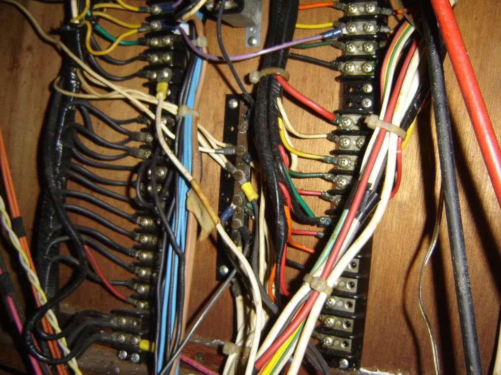

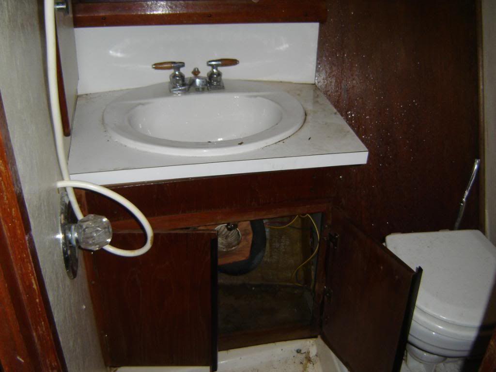

At least your wiring looks decent. I'm still finding places where the previous owners have wired multiple recepticles and lights on a single extension cord wire.
As i find them I replace them with good 14/2 wire
Ewww

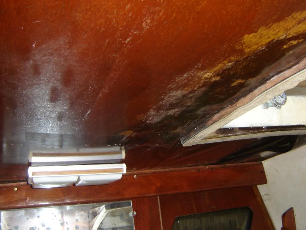

I hope this will come out.... You can at least cover it with the vanish and it would not look as bad. Don't know how you would replace it without a lot of ripping out

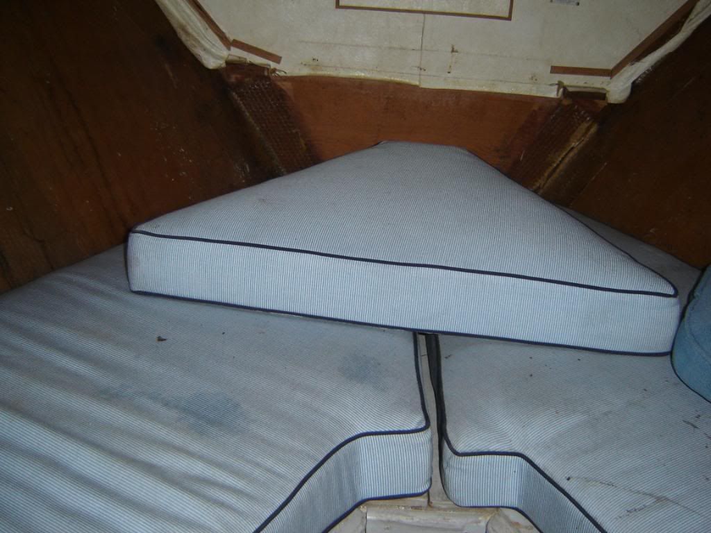

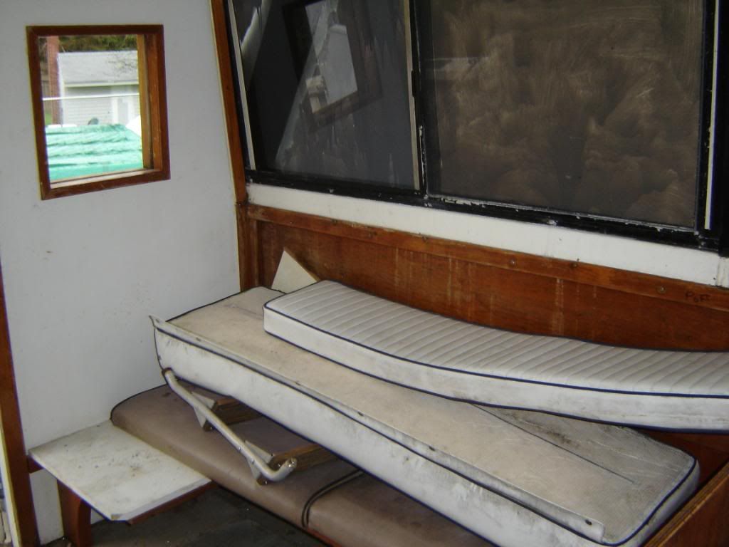

Cushions look like they would clean up nicely. Through those covers in the wash in gentle and all those little stains would clean right up.

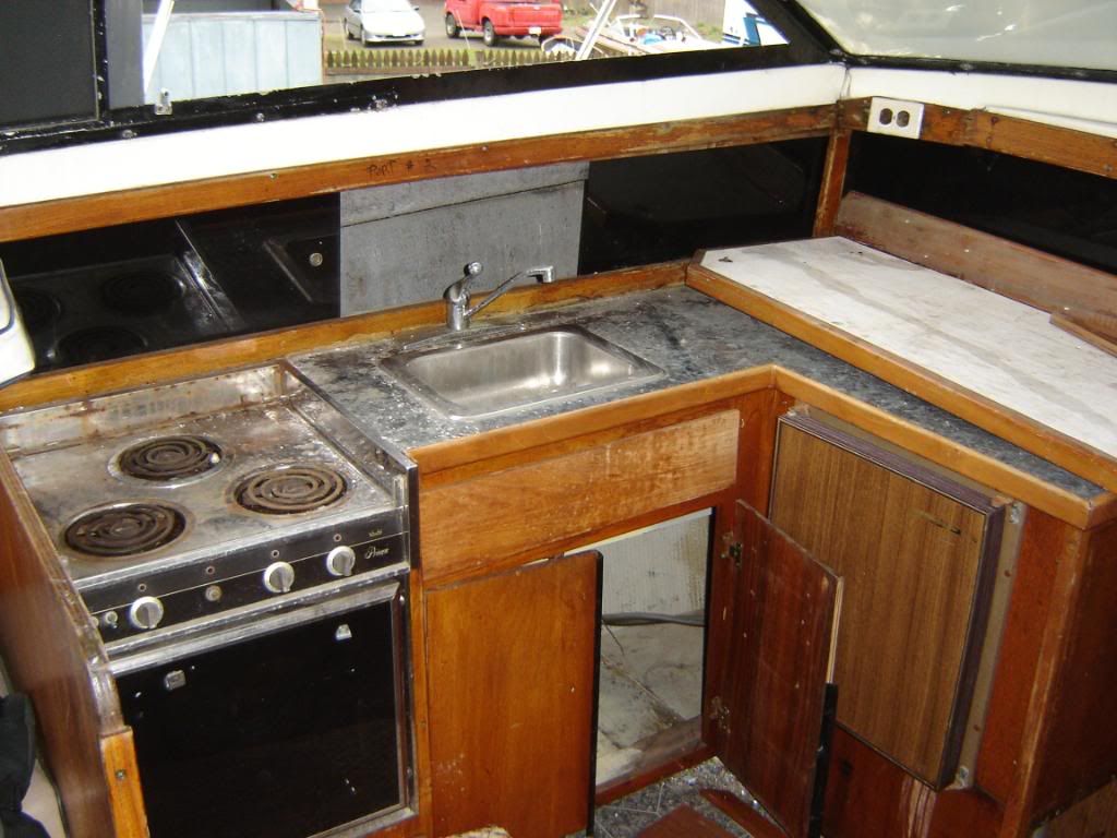

New up to date fixtures and counter top in here and it would look nice
I see some steel wool in your future.
Paint the fridge front black to match the stove...

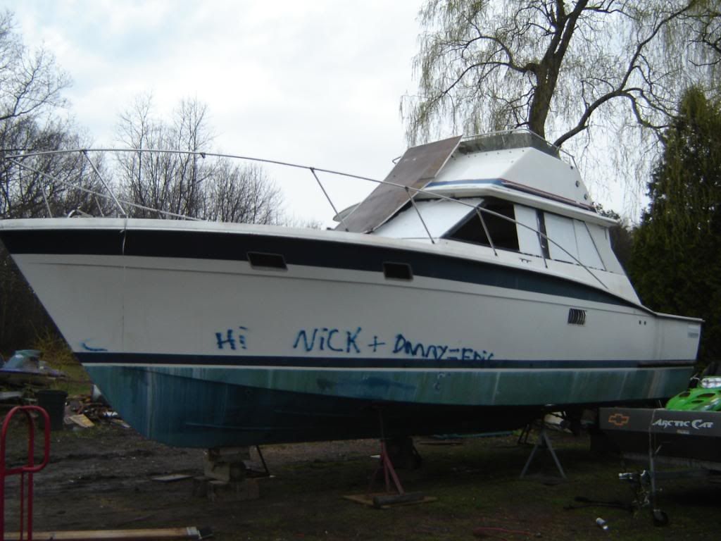

Who's Nick and Danny????
You can prolly buff Nick and Danny right off the GelCoat and bring up the shine. I just had my Oxidized hull brought back to life with a lot of elbow grease....

How is the hull? Any scares or holes?? Looks like a lot of fun if you have the time.... The end result would be VERY nice with a lot of handywork....
But really, clean it first and it will look great. Some people would look at that and see a piece of crap, but under the dirt and grime, there is a jewel waiting to be polished.

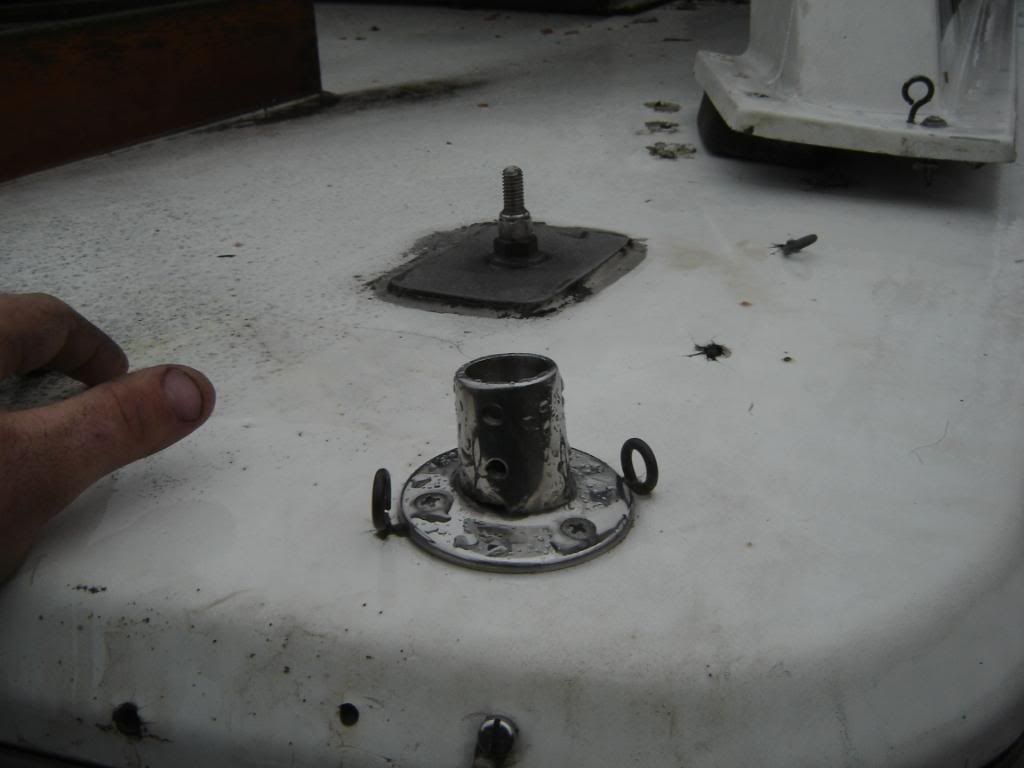

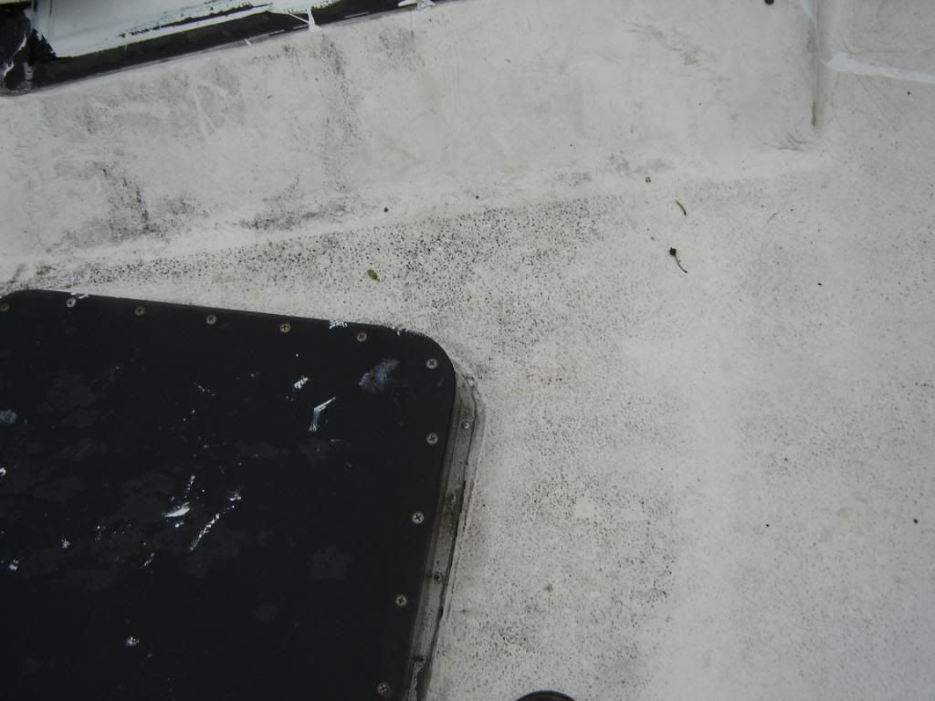

Looking at the photos of the underside of foredeck ahead of the windshield it looks to me like signs of moisture.
Are the decks spongy/soft? Take a rubber/plastic hammer and go over the top decks listening for dull sound rather than crisp ping when you hit the glass quite firmly. Any dull sounds suggests wet decks 'feature'
of old Trojans.
Not difficult to fix but does take time and a specific procedure to obtain good results. I am still a fan of using the original design crosscut balsa core rather than any of the newer materials. If they are wet I would suggest you start replacing them before anything else.
Key is to do it in sections to maintain rigidity, 4 sections at least on fore decks.
