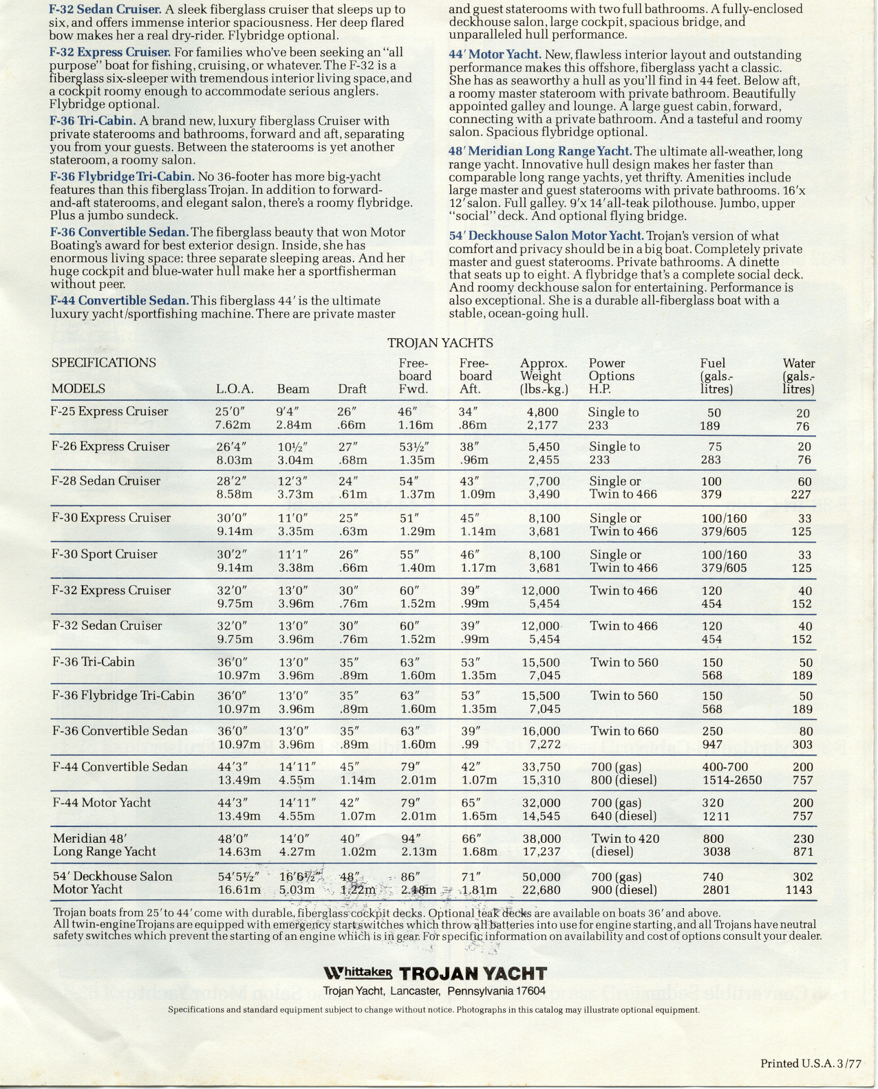

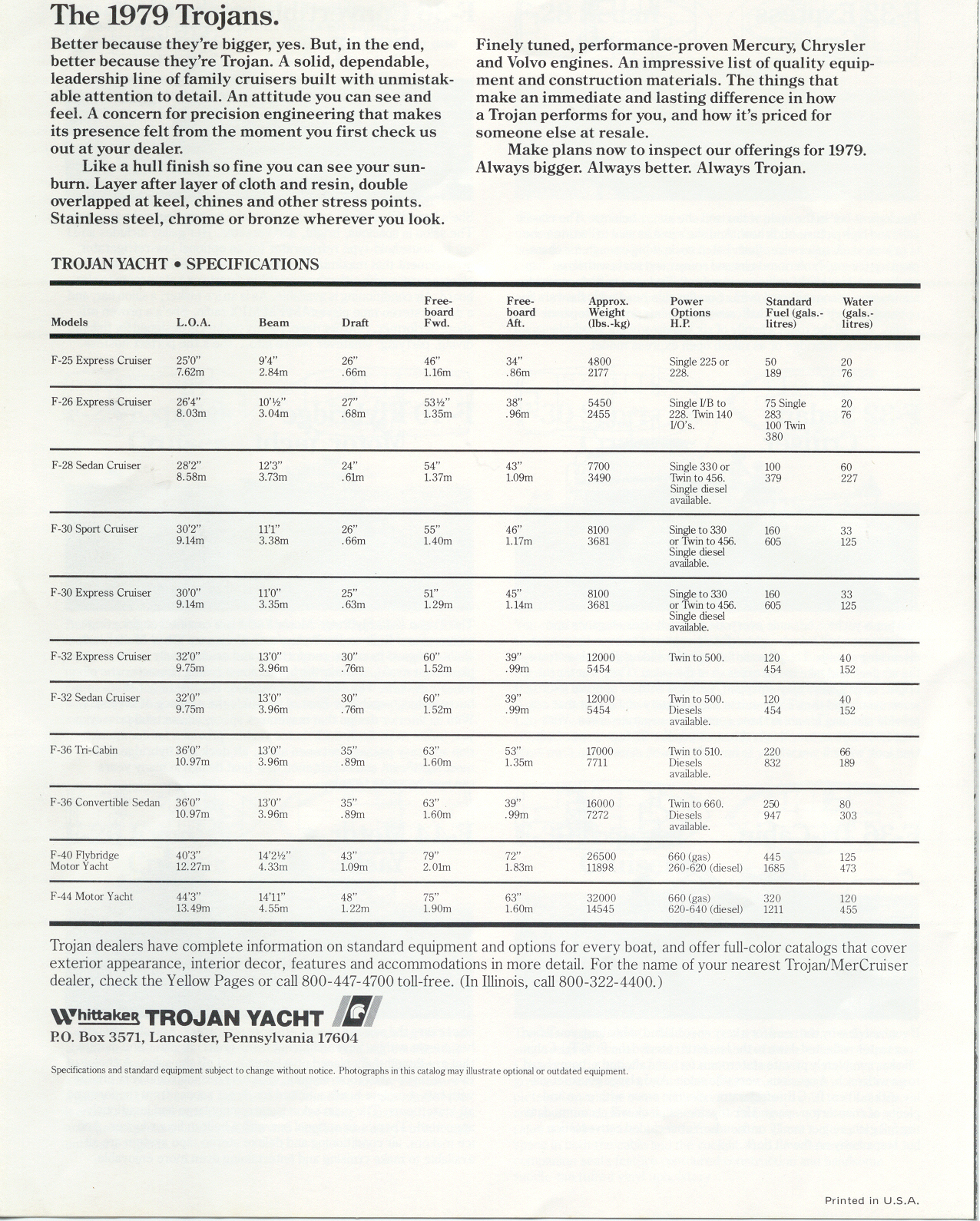

Well I ended up with a Trojan boat recently.. It is a 81'-84'??? 26.5'single engine. I would like to put it on a trailer and store it on one of my properties, But unforntionatly I do not know the weight... Any Ideas???

Ibelieve the manual for my 1978 F 26 says 6000 lb. dry. I figure on 6500 min. with all the extras on board. I haul mine on a dual axle aluminum trailer. I reccomend a triple axle tho.

Trojan literature for 1977 and 1979 says the F-26 weighs 'approximately' 5450 lbs dry (Gasoline weighs very close to 6 pounds per gallon).
1977:
http://www.trojanboats.net/images/1977% ... ATIONS.jpg
1979:
http://www.trojanboats.net/images/1979% ... ATIONS.jpg
