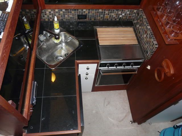

for those that might like to see. i installed black granite tile for the counter and slate tile for back splash. new (useable) larger and deeper sink with pullout faucet. also added 12v led rope light under cabinet to have indirect lighting on the backsplash. i am planning on continuing this theme in the head next.

Turned out real nice ...

I am getting ready to redo the galley in our tri-cabin this summer and you have given my wife and I an alternative to consider. Great job and it looks great. Thanks.

makes it look twice as big, nice.

Looks nice - we don't have the oven, just the stove.
Does everyone else have the oven - or what year did they start/stop?

Great job! It looks Awsome!

so, when are you going to come down river and help me do mine?
same weekend we do the floor? :D 8) :lol: :roll:

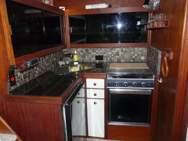

great job what is the dedicated circuit for?

the red outlet is powered by the dc-ac invertor only. the other receptacle by the stove in the galley is powered by generator and shore power. i have set up all the starboard recptacles on the boat with a switch that will allow them to be used by all ac sources (gen, shore and invertor)by selecting a source with a switch. the dedicated galley receptacle is run on a dedicated line to the invertor. i could not find a black single receptacle so thats why at this time its red. still looking for a black one to match but now i guess i'm getting used to it and it is a reminder that it only works when on the invertor.

Great job! You have given me some ideas for my new F32 galley

Beautiful job. Curious, why not just use a regular double black outlet as well instead of the red single?
Having said that, I think the different colour is a good idea. It puts people on notice that it's an inverter circuit and that lengthy high loads should be kept to a minimum and not left unattended for long.
