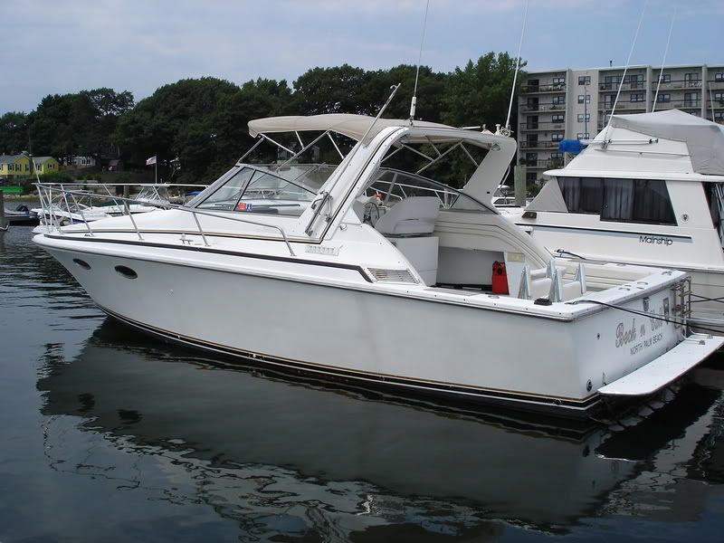

O.K.
I just saw the pic of your 10 Meter.
NICE LOOKING BOAT!
