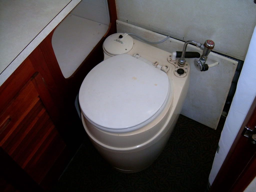

http://i948.photobucket.com/albums/ad32 ... IM4662.jpg

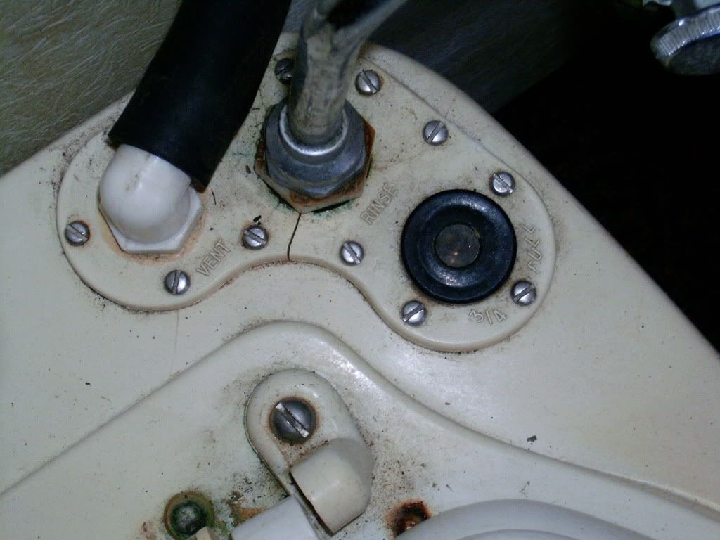

http://i948.photobucket.com/albums/ad32 ... IM4666.jpg

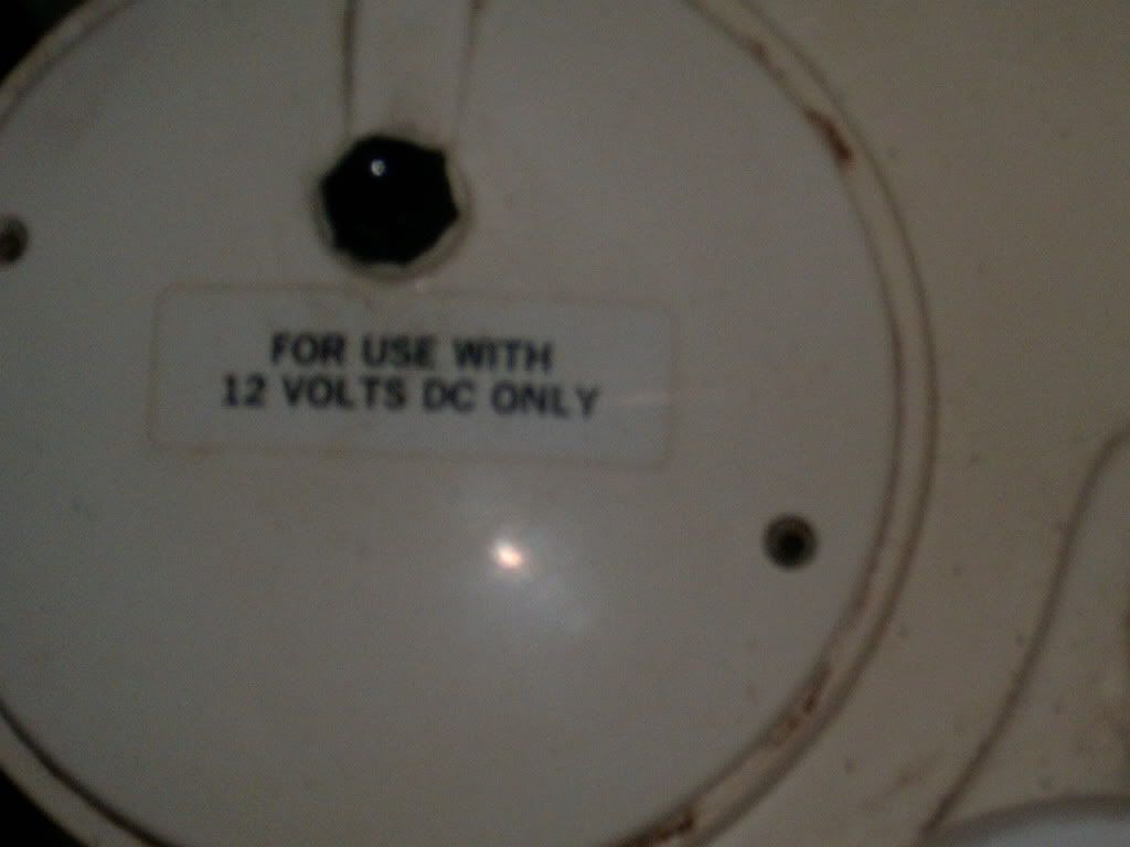

http://i948.photobucket.com/albums/ad32 ... IM4667.jpg
ick it looks like it needs a good scrub!
Found some instructions on the other identical head but not sure add chemical? I am really lost here guys I have only ever used a hole in the ground or a bathroom in a house... anyone ever used one like this?

Never seen one like that , But I can tell you for sure it uses fresh water to flush , I can tell by the valve in the first photo so your fresh water system needs to be turned on and working . It looks like the holding tank may be built in but thats only a guess .wish I could be more help
Looks like a recirculating unit. I agree that it is supplied by a water tank, not seacock/raw water. So, it must have either a holding tank that you manually empty, or empty via a pumpout. Does your boat have a plate marked "sewage" of something similar on the topside? Finally, just ask someone at your dock or marina for some assistance, but I'm still sure someone on this forum knows what's going on. You could send these to the guys at Beacon Marine for more information, also.

its a monomatic toilet heres the manual

g36 is correct, I have this same head in my F25 HT. Although I had to wire around the timer (it was bad, and to costly to replace, for me) and push the flush button down as long as it takes to flush, just a few seconds, it works fine. I do add a chemical to it, which you can get at West Marine and many other places too.
After each time it's emptied, I add 4 gal. of water and the required chemical and it's good for, depending how many times it's used.
