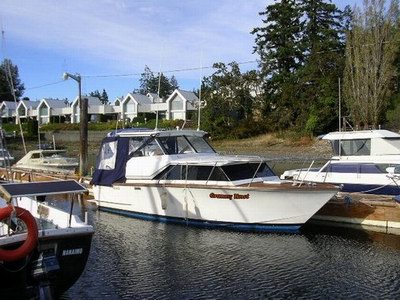

It looks like Trojan F25 to me that already had one round of rebuilding on the superstructure. Here is a 1974 model from the photo page of Trojanboats.net
(see http://www.trojanboats.net/TB%20Pictures.htm for more photos including a 1972.
