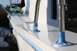

Larry, the first photo is of the 32 which was sprayed ($$$$$$$) and the second photo is the brush job on the the 26 ($) I can't really tell the difference. Is it worth it, IMHO- YES. There is nothing better than walking down to your boat and having it shine like the sun. After the 32 I said never again but when the wet sanding wasn't working out on the 26 I had a guy "roll and tip" awlgrip. This is what I learned- First, you got to do the window trim. If you don't the new paint will make it look old. as you can see in the photo I just took them out and painted them in a shed. Second, you must make sure the paint matches. I didn't do the hull and you can't tell the color difference, before picking out the paint get some color charts and see which color is close. Third, Awlgrip is a pain in the a$$ to work with but it is hard a nails when it dries. Fourth, you can't paint the non skid, the surface is to bumpy to get a good sanding for the paint to stick. It may hold for a while but over time you will see the paint on the top of the "bumps' coming off. I ground down all the non skid on the 32 and they applied nonskid paint to the decks, it looks fresh and new but again on the 26 I didn't want the cost so they just painted the smooth parts of the boat and with the color matching you can't really tell that the non skid is not painted. With all the prep work done the painter charged me $600 for painting the top and he wanted 1,000 (with sanding) for the hull, which I skipped. I paid $350 for all the paint and primer and he put 3 coats on. I hope that helps
