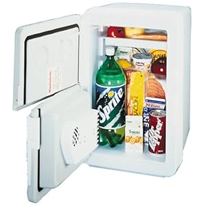

What is the Amp rating of that Fridge? You need to take that into consideration in the sizing of your Inverter and battery. Don't forget you have losses when taking 12V to make 120V, you are much better off staying at 12V.
If that is all you want to do what about looking at a 12V fridge to do that?
When I had a smaller boat I used Koolatron which plugged into a cigarette lighter. I brought cold stuff from the house and ran it in the car then connected it to the boats house battery for the weekend. This one is only $120.
http://www.amazon.com/Koolatron-Kargo-K ... B00009PGNR
