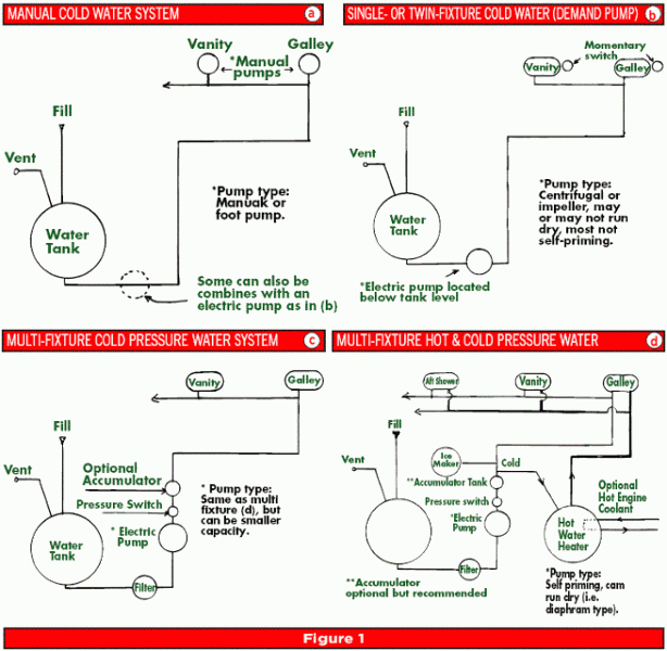

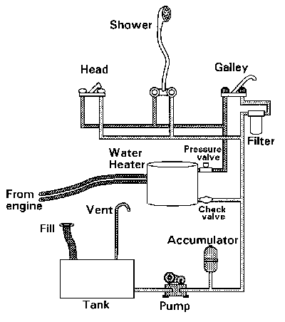

I was looking around for a good website explaining how to install a tank. I didn't find much. Here are some basic diagrams and one web sit I found. hope this helps. I agree with the last post I would get the biggest tank I could fit.

Thanks for your suggestions and help. The diagrams were most helpful.
