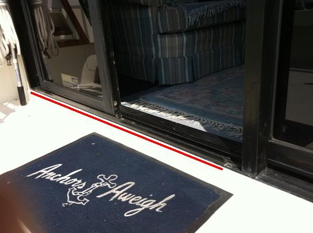

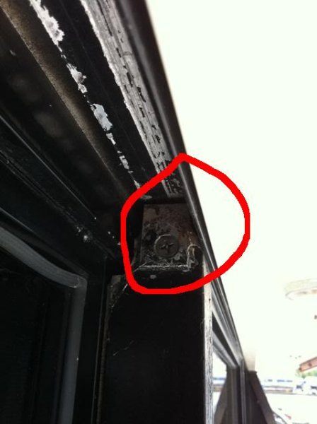

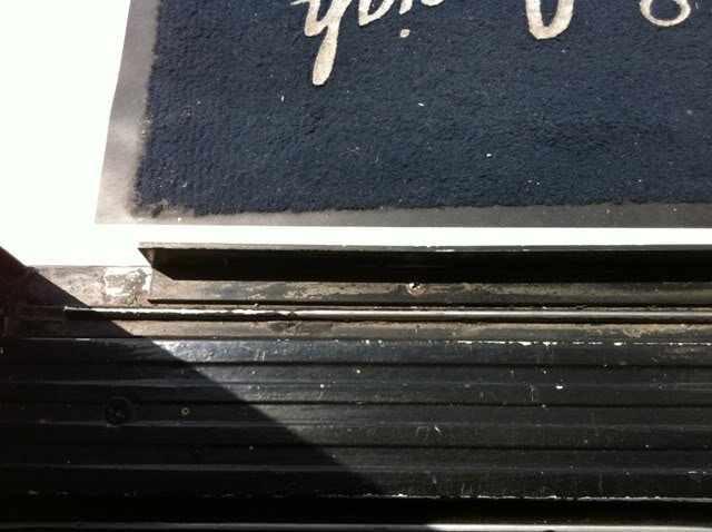

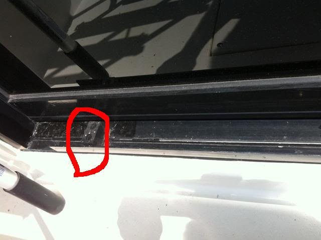

A couple of minor corrections... the little block that stops you from lifting the door is only on one end (the trailing edge) of the door, and there is a rubber stopper that also has to be removed with the L-angle. Here are a some pics.
L-angle itself runs almost the full length of the area that the door slides in.
Fastened down by a half dozen screws. Open the salon door and pull what you can, then close the door and pull the rest. This shot is taken from inside. The little rubber stop that the door bumps up against when you open it to the max also has to come off - there is a screw hidden underneath it. Then there is this one single block (that normally keeps you from lifting the door out of its track) at the top of the trailing edge of the door that has to come off.
Then lift, and pull out from the base as described before.
