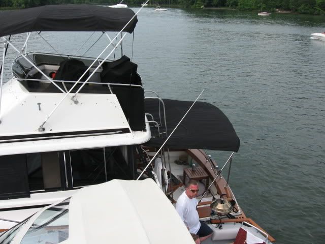

i think having the teak wood all the way around looks great. i think that was one of the really appealing aspects of my boat. course i guess i am a bit partial now. i havent got any confirmation but someone mentioned this being a medallion editon but i havent really found to many references to this . i keep meaning to ask bob about that
not great pics but heres a couple
Image[/img]
