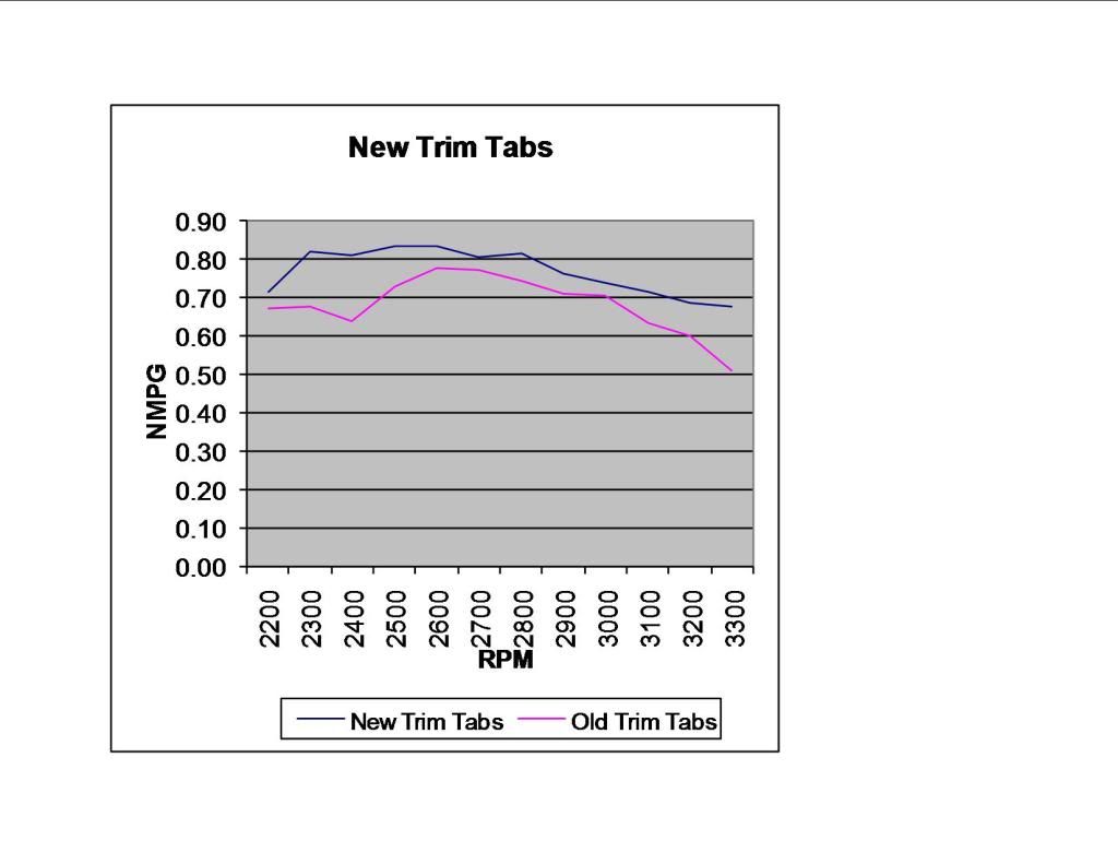

here is some data on the 1983 Express Cruiser (non-midcabin) for comparision:
4 blade props 18x19
machined exhaust diverters
bigger intake spark arrestors
repaired spark advances
corrected metering rods in the quadrajets
replaced factory 9x24 trim tabs with 12x24 tabs with drop fns
76 gallons of fuel
40 gallons of water (full tank)
one adult & one yellow lab (Hank)
Test data November, 2003
Here's the detail @ 2800 RPM followed by a graph that compared results before the tabs to after the tabs.
Note: I cannot recall ever having to run these tabs full down.
RPM 2800 (digital tach/sync - ENSIGN)
GPH 19.0 (flowscans)
KTS 15.9 (gps)
MPH 18.3 (gps)
NMPG .84 (calculated from GPS & Floscans)
Here's a graph:
Not a midcabin, but hope this helps y'all.
graph is below
4 blade props 18x19
76 gallons of fuel
KTS 15.9 (gps)
MPH 18.3 (gps)
Here's a graph:
graph is below

These tests with the gas engines were all done with PROBABLY, actually MOST ASSUREDLY with NON-ETHANOL fuel.
That may have a significant bearing on differences from then to now.
