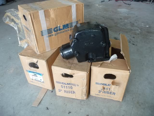

risers: I have two sets in my garage I would sure like to get rid of, I bought them for my old engines , then pulled the motors, they wont fit the new ones
No offense, but I wouldn't put GLM risers on my engines...
Osco, Barr or Mercruiser ($) Had great luck with Osco over the years.
gettaway
Posts: 1142
Location: Coronado CA
Post by gettaway »
no offense taken, and they are not going on the boat

Stripermann2 wrote:No offense, but I wouldn't put GLM risers on my engines...
wHY ?
f boat ( glass )
TROJANS !!!
wHY ?
Bottom line manifolds and risers,
their castings and fit are subject to early failure and corrosion.
Chinese made...Caveat Emptor
