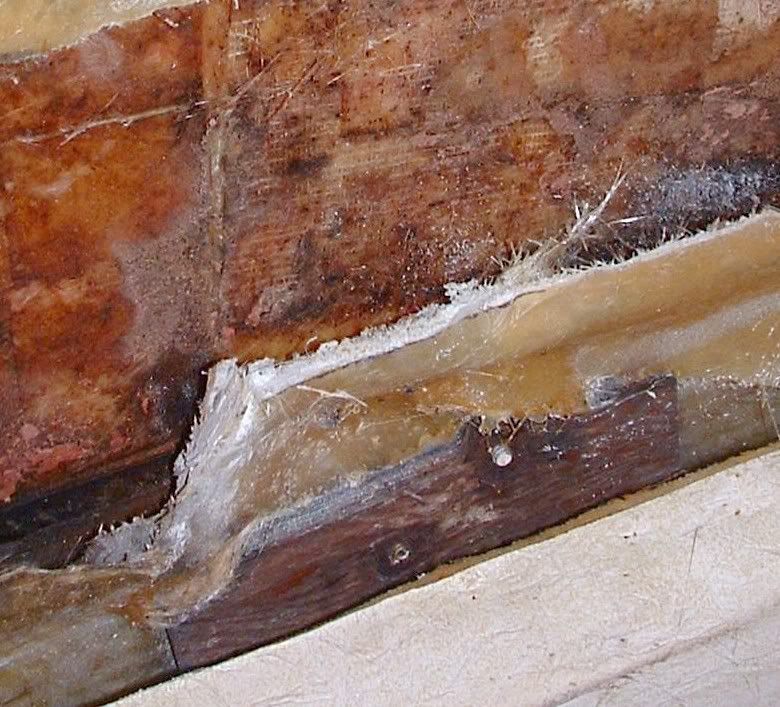

When I had my F26 surveyed prior to purchase, the surveyor found that the foredeck and the forward couple of feet of the sidedecks had wet cores. I negotiated a much lower price and fixed that myself by installing a new balsa core from beneath the decks, and re-fiberglassing.
I decided to strip out all of the vinyl cabin ceiling and sidewalls. It was then that I found something that the surveyor could not possibly have seen due to the vinyl coverings. The stanchion bases are anchored to "T" nuts imbedded in plywood blocks under the decks, using machine screws (the cleats are bolted through the deck and their own under-deck plywood blocks). Clearly the stanchion bases and cleats had not been properly caulked for some time, because all of the plywood blocks were rotten and all of the nuts without exception were rusted and crumbling. Moreover, nearly all of the machine screws were corroded and thus thinned down to a fraction of their original diameter. Clearly the builder had not used stainless fasteners. I had to drill out some of these machine screws.

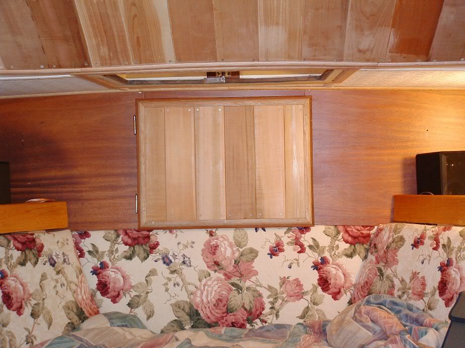

I then replaced all of the blocks with marine grade mahogany plywood and used stainlesss crews, washers and nuts. I have installed a new ceiling throughout the cabin, making provision to be able to get at and tighten all through-deck fasteners from beneath.

Here are a few photos that indicate the issues to which I referred, concerning the damaged backing blocks, corroded T-nuts, and corroded machine screws holding the stanchion bases to the deck. Also shown are the corroded bolts holding the side cleats (I was wrong in saying that there was an original backing block for these). All of these were concealed and inaccessible under the vinyl coverings. The third photo indicates the new backing blocks and stainless fasteners that I installed. The next pic shows the original standard vinyl covers. The final few indicate some of the improvements that I have made, including the new side shelves. All fasteners are now accessible from below for tightening etc.
