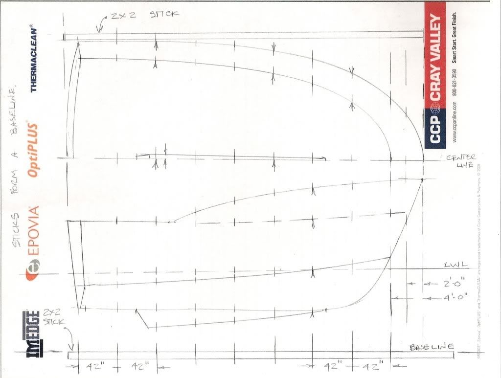

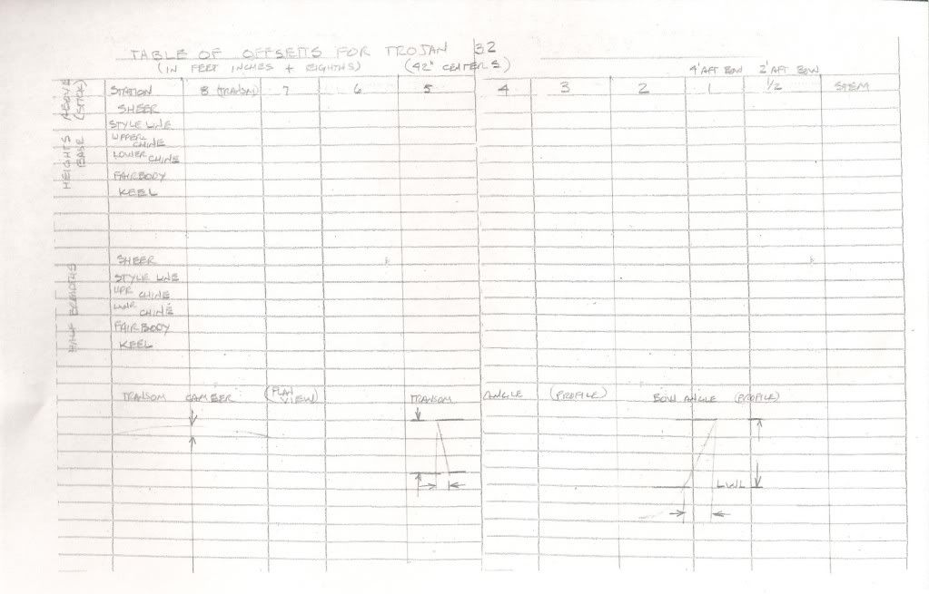

As I stated before I have always thought of building a model of the 32, now that I see the there are other members wanting the same thing it may just lower the cost to a point that makes it cost affective. I contacted the NA that I work with and this is what he sent me, with this filled out he can make a scale drawing of a f-32 hull. Once I have the drawings I can get a price for the plug and molds, only then will I be able to price this project out. I may turn out to be to much but at least I'll take it that far. I know that some members offered to help with the measuring but I am a little hesitant to ask as this project may get shut down after the drawing are done. My boat is in the water but I should be able to find a 32 in the area, I think? I know where a junked 32 is but the yard dog does not look like the cute little dog that sleeps on my couch so I think I'll pass on that one. Anyone have a 32 out of the water within 50 miles of Lauderdale?
Below is what the NA sent me and I have no idea what it means :shock:
Doug
here's the forms, including an example from the old hargrave office
the measurements can be 3' - 8 1/8" as opposed to feet-inches-eights -
i don't now if your 32 has a second spray type chine or just a single -
you'll have to put down a couple of sticks on the ground to form baselines -
you may have to level the ground a bit to for a "base" to measure from
call if you have questions
greg
