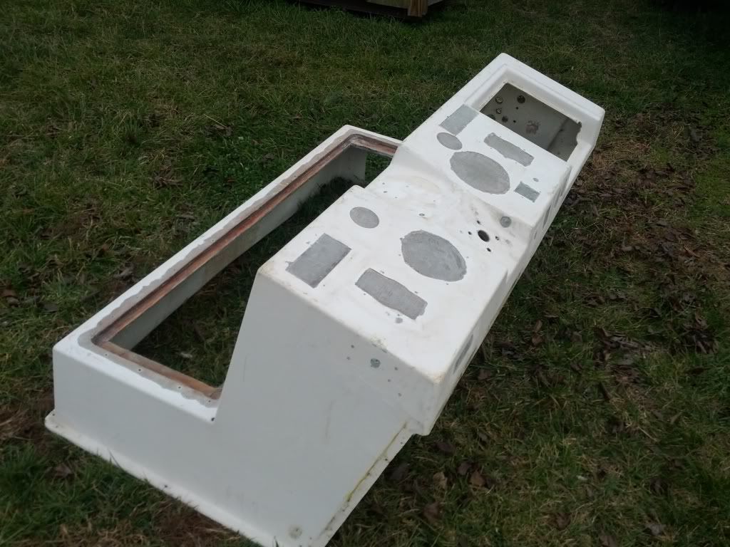

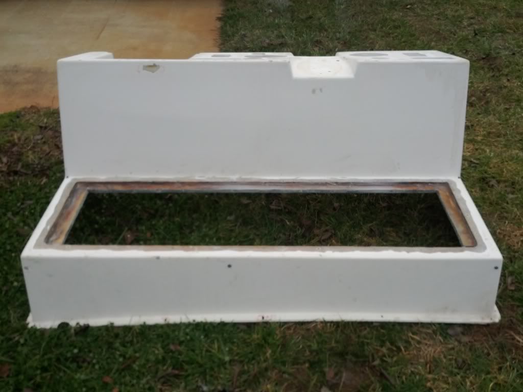

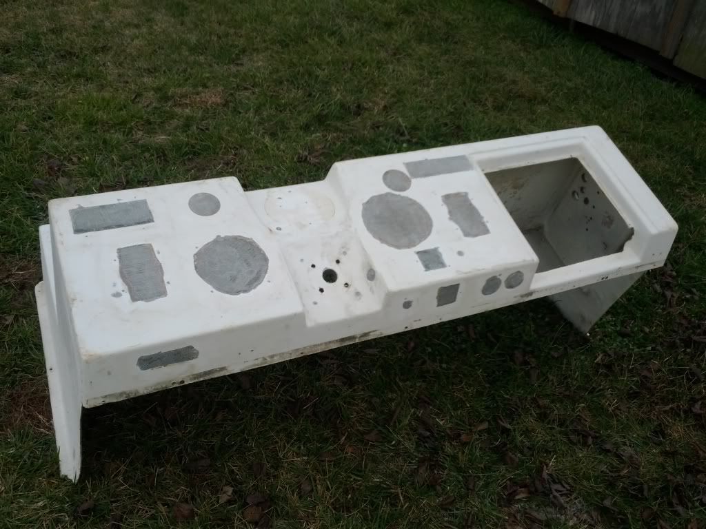

I have posted a few photos of our flybridge. PO had cut out seat bottom and done a very bad job so we have smoothed some of those edges and have filled all the random holes that they had drilled over the years.
We are just in the rough in glass stage at this point.
No symmetry in the PO helm layout...mixed up mess.
Were going down to one helm chair with controls ,navigation and communication equipment off to the starboard side and entertainment on the port side of the helm.
PO had cutout the seat bottom and left me no choice to repair or utilize...we choose to utilize fully understanding that it will not be dry storage. Happy at this point to have the extra space.
Doing some finish glass tomorrow...gonna be vacuum bagging!

lol im all for extra seating as well, the f36 only has one chair as well but thankfully there's a bench not to far behind it, thinking of ripping it out and redoing it as well since there's so much wasted space under there
In my personal opinion there is not really enough room to move around with two seats behind the helm. The bench seat ahead of the wheel allows me to see all bridge riders and places them in a safer seating position.
Another reason we decided to go this route is the boat came with two brand new very nice matching helm chairs...were using one below and one on the bridge.

Wow. Lots of fill on that bridge helm was needed huh? Looks like the PO had a gadget in almost every possible spot. Nice work reversing that nightmare.
One thing I never really cared for on the F-36 bridge was how the gauges were shifted off to the Stbd. On the 32 they are centered and in front of the operator. Just always thought it was kinda out of your line of sight and forces you to repeatedly look in a place that isn't really intuitive. (down and to the right) Since you are doing the bridge helm completely over, will you be keeping the original location of the gauge clusters, or modifying it to have them in a different location?

The PO had a huge mess going on at the helm...those larger holes were stereo speakers.
I have bought some single lever electronic controls so that will save some space and we are going back with Murphy Powerview mulit gauges that will be mounted adjacent to the shifter.
We originally discussed making the gauge area into a cooler...now looking at making a new insert and flush mounting a few switches and some electronics over there as things are getting crowded on the gel coated flat panels.
