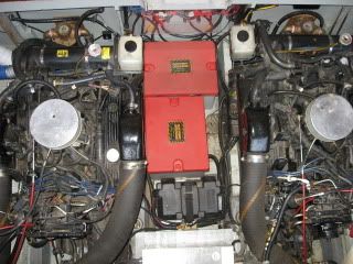

this picture is what I used to have in the boat. everything has been gutted, rebuilt, cleaned and ready for bilge coat. I was looking for battery box ideas. I dont like the plastic containers thats there. Also they are covered in oil so bad Im just going to toss them. So if you guys have any pictures of what you might of done in this area i would love to see them. thanks.

This is my setup. 3 battery boxes. The red tops originally had 2-6V each, now there's 1 group 29 in each box. The shared starter battery is in the black batt box. My 30' Seas Raider has the same layout as your F30......John
