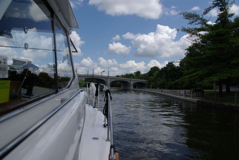

The white you see was painted three years ago. It was done by roll and tip method. No brush marks and better yet no orange pell effect that you get from spraying. There is a very nice Riva beside my boat in storage. It is varnished but done the same way.

paint job looks great, I'm getting courage from all that I've seen from others that I'll be able to do it with some practice ...
