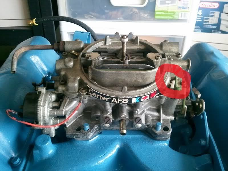

First of all, I know nothing about carberators. You have to explain it to me like your talking to a third grader. lol. I have no idea about the jets, And I dont know what you mean about the accelerator. I know the chokes are different, but when I took the old engines apart the one with the electric choke had about a 2 foot long red wire on it, but it wasnt plugged itnto anything on the other end. where does it plug up to? Here is a top view of both of them.

kallen wrote:The carb with carter afb has the accelator "s" linkage backwards. This carb is the replacement for the orginal afb. The electic choke is great. But make sure that the chokes comes off quickly
I think he's talking about this "S" clip from the accelerator arm to the pump, circled in red...Also, I believe you should only have flexible fuel hose, marine grade and crimped from shut off valves, water separator or manifolds to fuel pump. From there to the carb, should be rigid fuel line. And, the throttle lever stop tang is bent, just to the right of the circle in pic.
antlr-king wrote: the one with the electric choke had about a 2 foot long red wire on it, but it wasnt plugged itnto anything on the other end. where does it plug up to?
+12v when the ignition is on.

You need the specs for those carbs to make sure they are jetted the same and are flowing the same CFM"s ( air flow Cubic Feet per Minute ), I think 550 CFM's is fairly common also the positive wire from the choke needs to go to ignition 12V possibly from the rear of the alternator if you can find the wire that gets hot with ignition.
