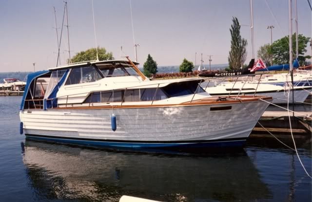

In the last post, I was really referring to the edges of the cabin roof area, under the vinyl. To 'splain a bit better ... on our '69 there was an overhang over the side windows (like on your cockpit roof)...
You might be able to make it out a bit in this shot
This overhang was curved, and was made out of a specially shaped piece of wood. Looking at your pics I guess it's not obvious that you have an overhang over the cabin windows, so maybe you don't have the same contours to deal with.
But just the same, there will be some kind of joint and carpentry involved in how the top and sides come together (above the windows, as well as in front of them, plus the forward edge) that you may need to craft something new to keep the same shapes.
