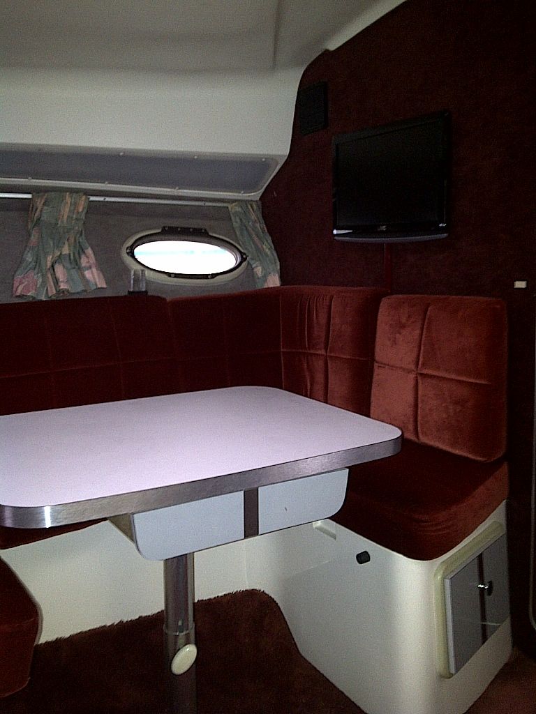

On the TV mounting part of your question I went to Best Buy and bought a regular wall mount bracket. I was able to use bolts and nuts to mount the bracket. I have a 23" tv and it rides fine.

Thanks. I looked at one at Best Buy. I'm reluctant to drill a hole in a fiberglass wall. Did you mount it in the starboard wall, between the galley and the salon?jhalb wrote:On the TV mounting part of your question I went to Best Buy and bought a regular wall mount bracket. I was able to use bolts and nuts to mount the bracket. I have a 23" tv and it rides fine.

I have a 10 Meter and I mounted the TV on the wall between the head and cabin.
