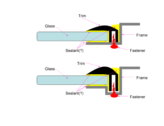

Here is a thread from a while back re replacing one panel on my '79 F32.
viewtopic.php?f=1&t=1042&hilit=window+window+trim
And here is the diagram I referred to. Not sure if the frame is flush (top pic) or recessed (bottom pic).

Thanks, that is a great diagram!!! I will compare it to what I see on my boat this week. It doesn't look like a difficult job, just time consuming.

Bars : I hired a guy to deal with it for me(worked out to my advantage - he got the trim off without damage, got the old glass out, had a piece of replacement glass cut, slipped during the installation and cracked it, and had to get another piece made...). He went to a glass shop and told them what he was trying to, they sold him a special tool to deal with cutting out or through the caulking in this configuration. Think it cost him about $50.
[Note : I am a true Canadian, always apologizing for things we didn't do. Even though he cracked the first pane of glass on his own, I still paid him for 2 panes... he was doing me a favour as I had already fired one numbknuts (not a real word, but read it slowly and you will get what I mean) who was supposed to fix the window over the winter but screwed me around and lied to me for months and did more damage than good. I still paid for 2 panes of glass, but only 1 set of labour and didn't have pay for the tool. If I had done it myself I probably would have had way higher costs - I probably would have messed up the trim and broken 1 or 2 panes of glass....] First time I have ever paid MORE than an invoice value, but this guy is worth it! He has been trying to retire for years but people won't let him.
