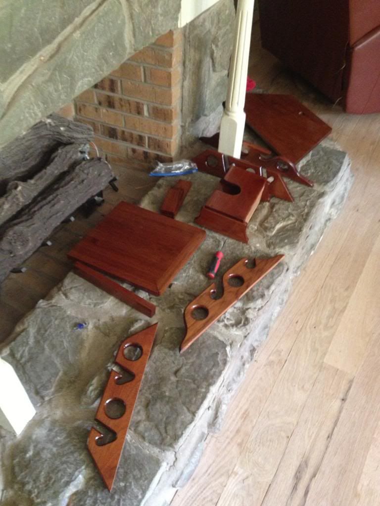

im doing everything in z-spar captains varnish heres a few odd and end pieces
if i buy pine plywood will the varnish make it match up
