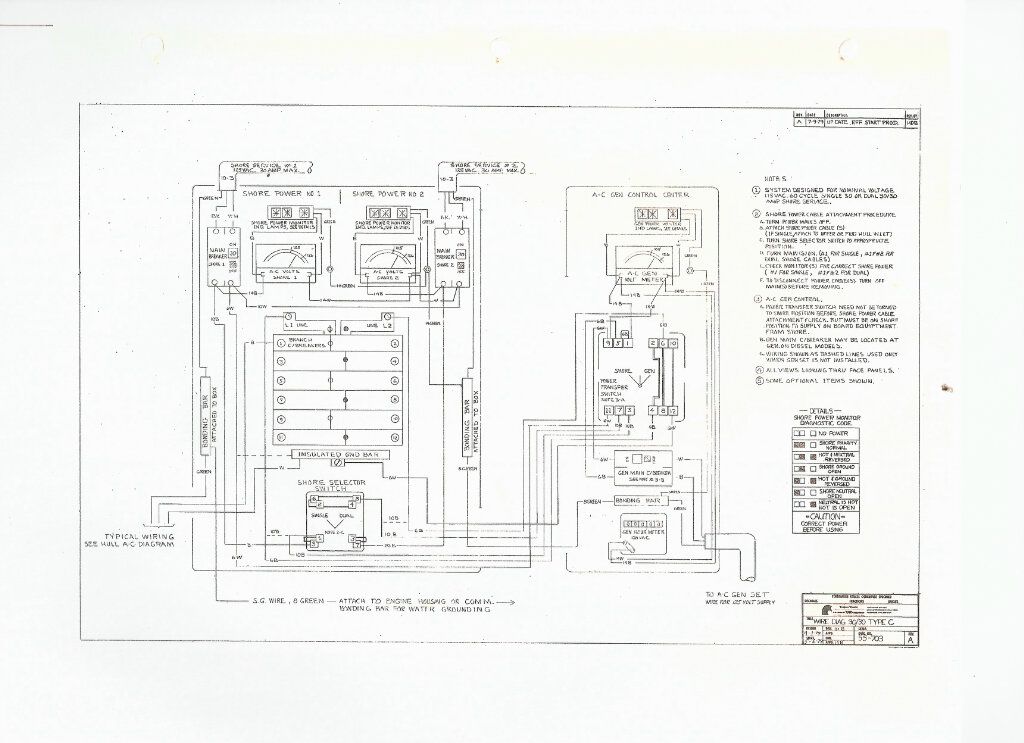

Re: Shorepower indicator lights - Int'l
This is the AC schematic for my 10 meter. It shows the shore power monitor diagnostic code.
John,
Thanks, that's also imprinted on the panel itself. So after screwing around with the LED's, I ordered the ones that Harris posted. They're only two bulb displays though so the legend on the panel becomes useless.
