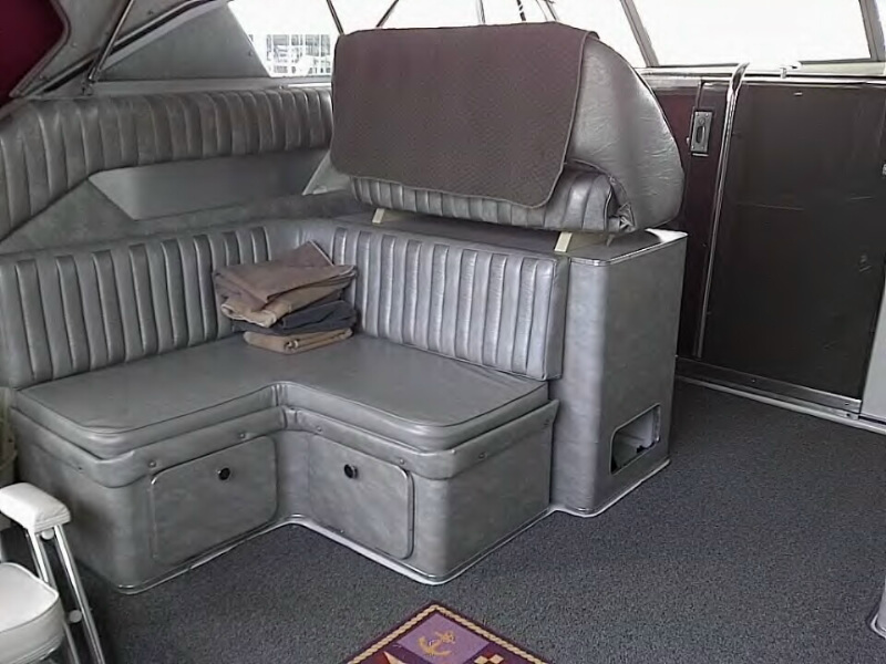

jhalb
Posts: 354
Location: St Louis Mo.
Re: mid cabin helm seat question
Post by jhalb »
This is my port side seat.
Seat 2.jpg (143.52 KiB) Viewed 3882 times
John
"PELICAN"
1983 10 Meter Express
