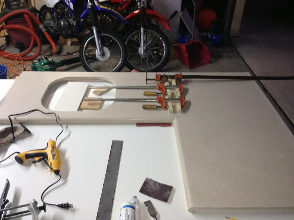

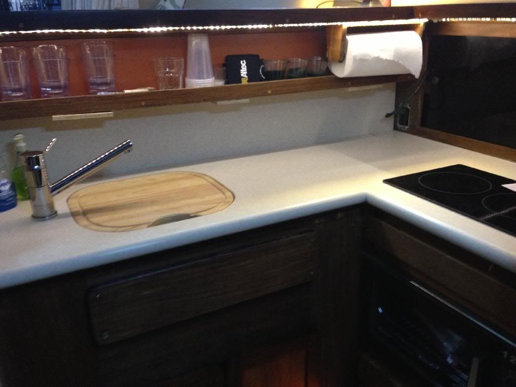

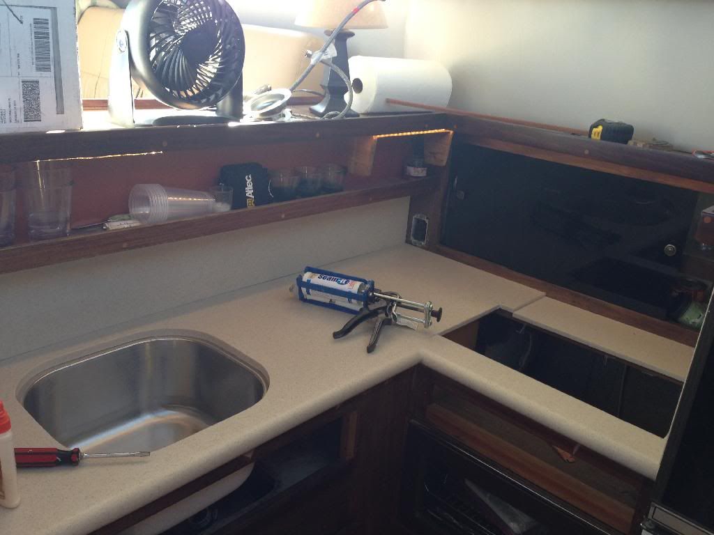

This past weekend I replaced the counter tops with Corian, I did all of the fabrication and installation myself and while I have some detail work to finish, so far it has turned out to what I think is an amazing transformation.
I will enclose the shelf just above the sink with tinted plexi sliders that will match the other sliding door cabinets this coming weekend and i have some teak trim to take care of, but for the most part, the hard work is complete.

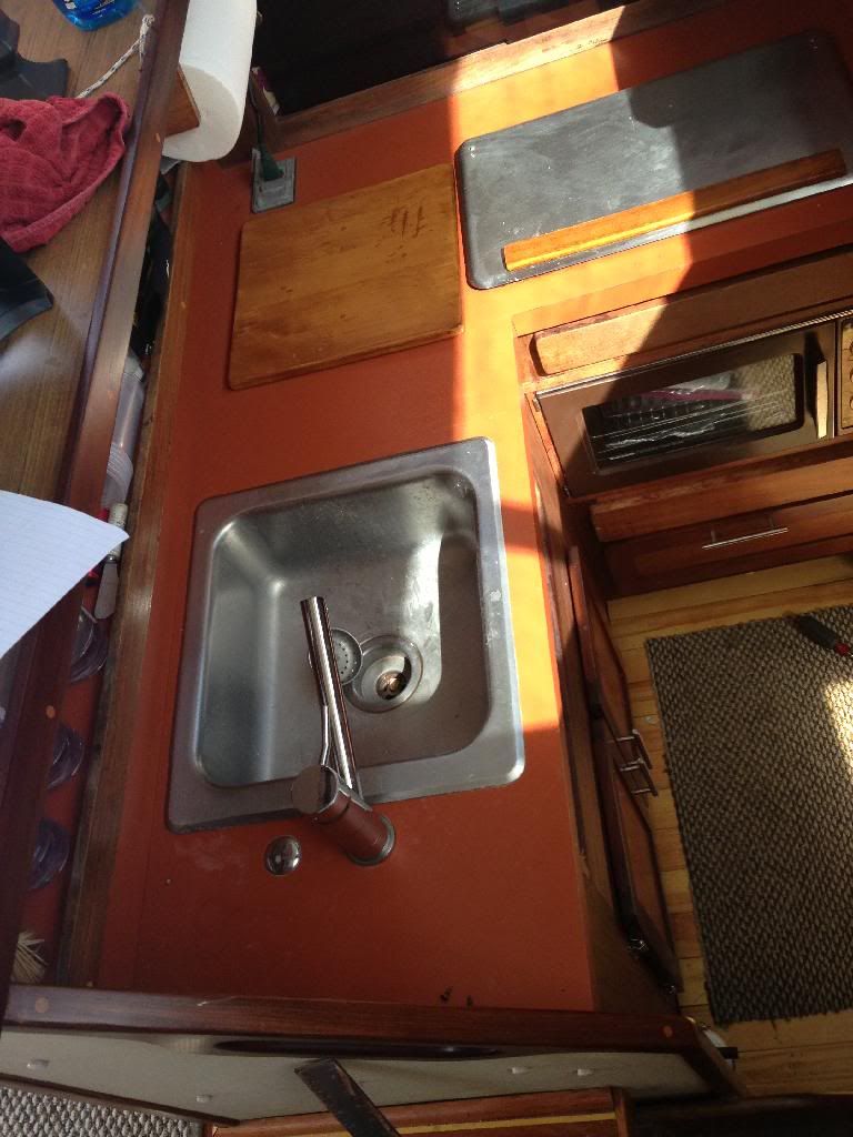

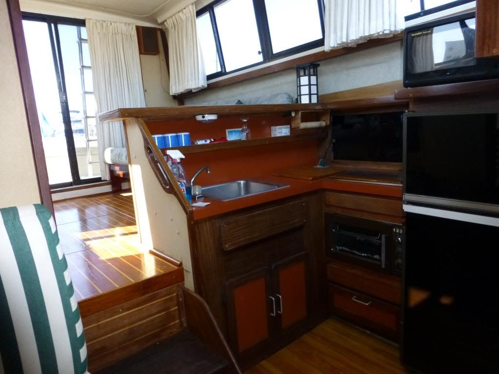

This photo is from when we bought the boat

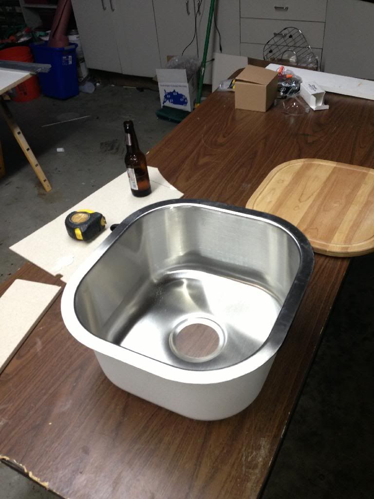

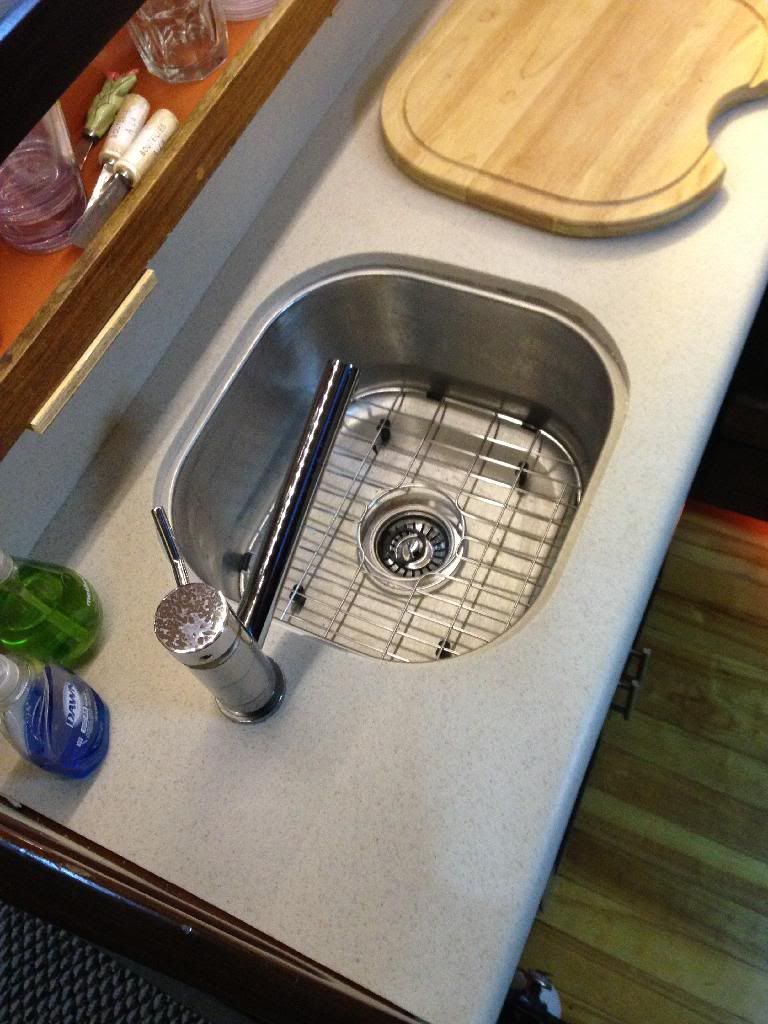

new SS deep sink

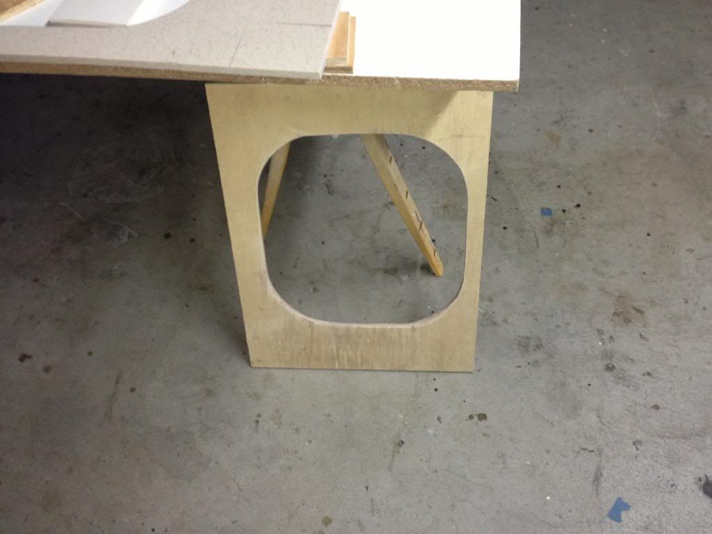

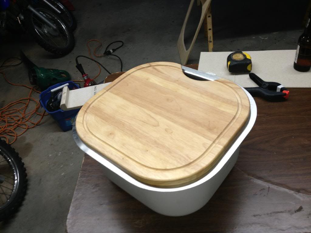

Template I made for the sink cut out and to give a 1/4" reveal to support the drop in cutting board

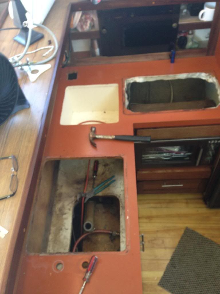

Tear out of the old counter and fixtures

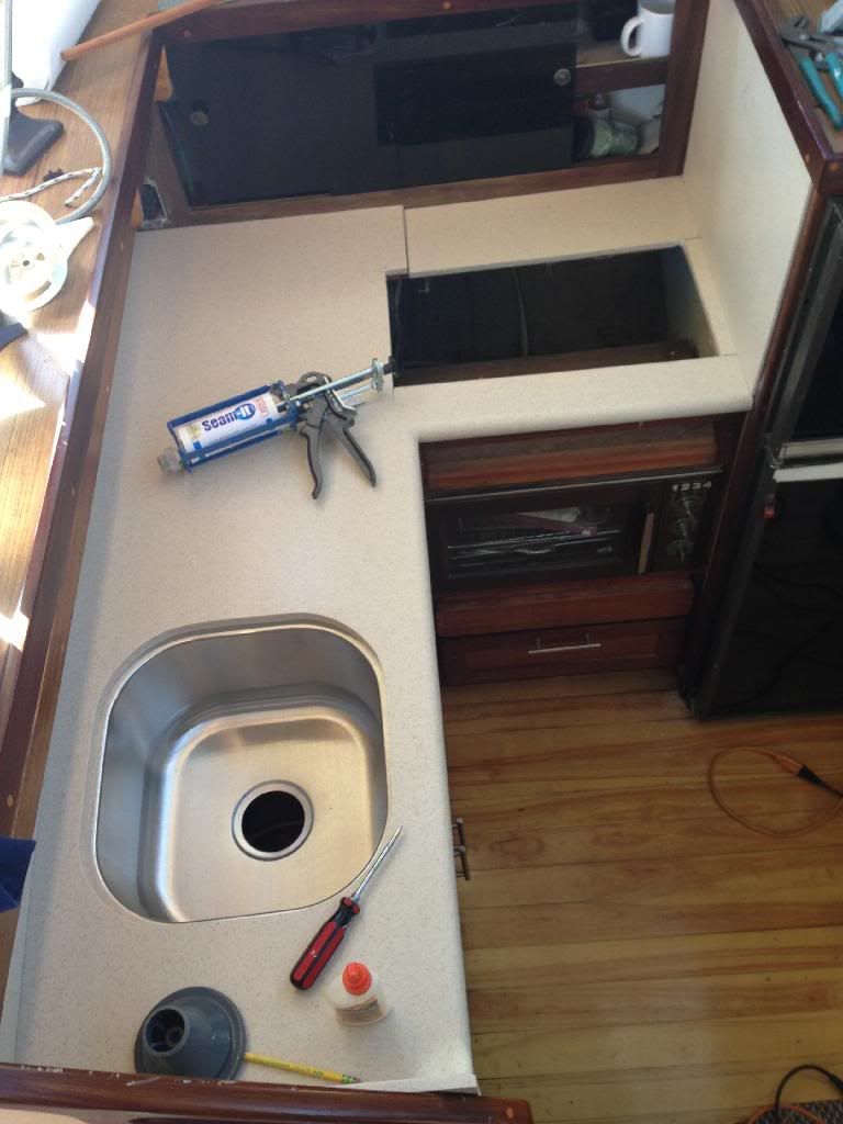

New top going in, I had to cut the corner out to get the top into place

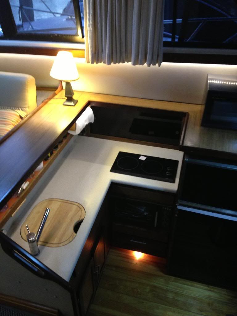

New top and the boat cleaned up a bit
New cook top
