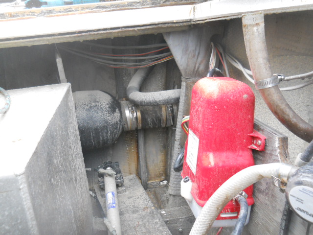

Mine are either plasic or fiberglass. Just looking at them I'm thinking plastic. Attached is an old picture that shows the end of one.

I would guess glass . Look close at it if its glass then you maybe able to see the fibers . http://www.centekindustries.com/vernatoneround.html
Re: Original Mufflers in F32
I've seen one of these blow due to a backfire. Appeared to be fiberglass. Nothing much to them at all.
