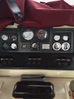

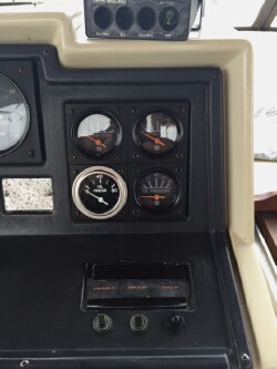

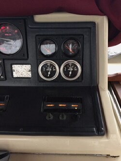

greetings from memphis...and spokane tomorrow. on the road for work. HOWEVER, this past week i finally got the gumption to give my instrument panel a slight face lift. the gauges are tired and showing their age. some needed to be tapped a bit just to give a reading. i've decided to honor the tri cabin i grew up on, and swap out the old DATCON gauges with seastar/teleflex heavy duty gauges. i love the look and they are really easy for these old eyes to read. eventually the others will be $$waped out, but, for now, the oil pressure gauges were the most important as last year they started to get a bit of a 'tick'. they would swing from one direction to the other, and the port one just passed away and rested below horizontal never to be resurrected no matter what. i knew it was a bum gauge when i swapped out the starboard gauge for the port one and it read. my question is this. the only ones that cannot be changed are the hour meters. any ideas? is there a way to hook new ones up to a battery and let them run to catch up? the boat was repowered in 1996 but i do not think the hour meters were changed out. why i have no idea as it would make sense. right? i know if i were to have them replaced or rebuilt to ''0'', i'd change them.
here are some pics for you guys to enjoy/scrutinize.....
aaron
(the original terminal 'quick connect' modules could not be used for the new ones. the new terminals had to be individually wired using ring connectors and connected with the lock nuts provided by the manufacturer.)
